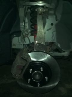

  #462
Jkwon85's Avatar
Joined: Nov 2009
Posts: 27
Smile 03-04 G35 SedanRWD/AT.Sport Package question
Hey guys I got an 04 G35 RWD with the sport package, my only question is does anyone know the manufacturer of the red struts and springs? I dont know what brand Nissan/Infiniti uses for their sport suspension components but its a thing i would like to know. One last thing I want to lower my car a little bit, but i upgraded my tires to a wider rating 225/55R17 opposed to the 215/45R17's that come with the sport package. Would tire size affect clearance if i lowered 1"? Thanks guys. G Riders 4 EVA!!
heres a pic of my setup, Just put in brand new HAWK HPS pads,and Centric Plain 120 rotors all the way around!! Stops like a dime, Highly recommend this setup for sedan drivers. Enjoy!
Attached Thumbnails !!Look here before starting a new thread!!  2003-2006 Sedan FAQ's-newbrake.front.jpg   !!Look here before starting a new thread!!  2003-2006 Sedan FAQ's-newbrakes2.jpg
