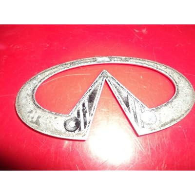

Q - Can I debadge the emblems on the rear of my 1st gen sedan?
Yes - except for the mount fuji emblem which has rivets (holes). picture here
The other "INFINITI" and "G35" lettering is attached by double sided tape and can be easily removed. The most common way is to heat them with a heat gun and remove with dental floss. Then use goo gone or similar to remove the extra tape. Finish with a good wash, polish and wax.
