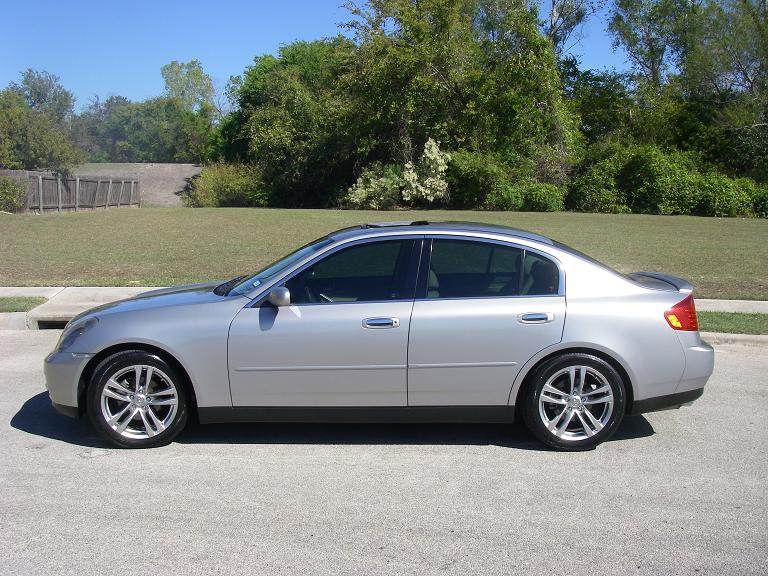

Thanks for the info. I guess I will start with coupe all around and see how it looks. Can always modify from there if needed. If any of you come across some good coupe all around pics please let me know. I will continue to search on here. I don't have a huge gap to fill since my tires are a little larger. ~1.75 up front and ~1.25 in the rear.
