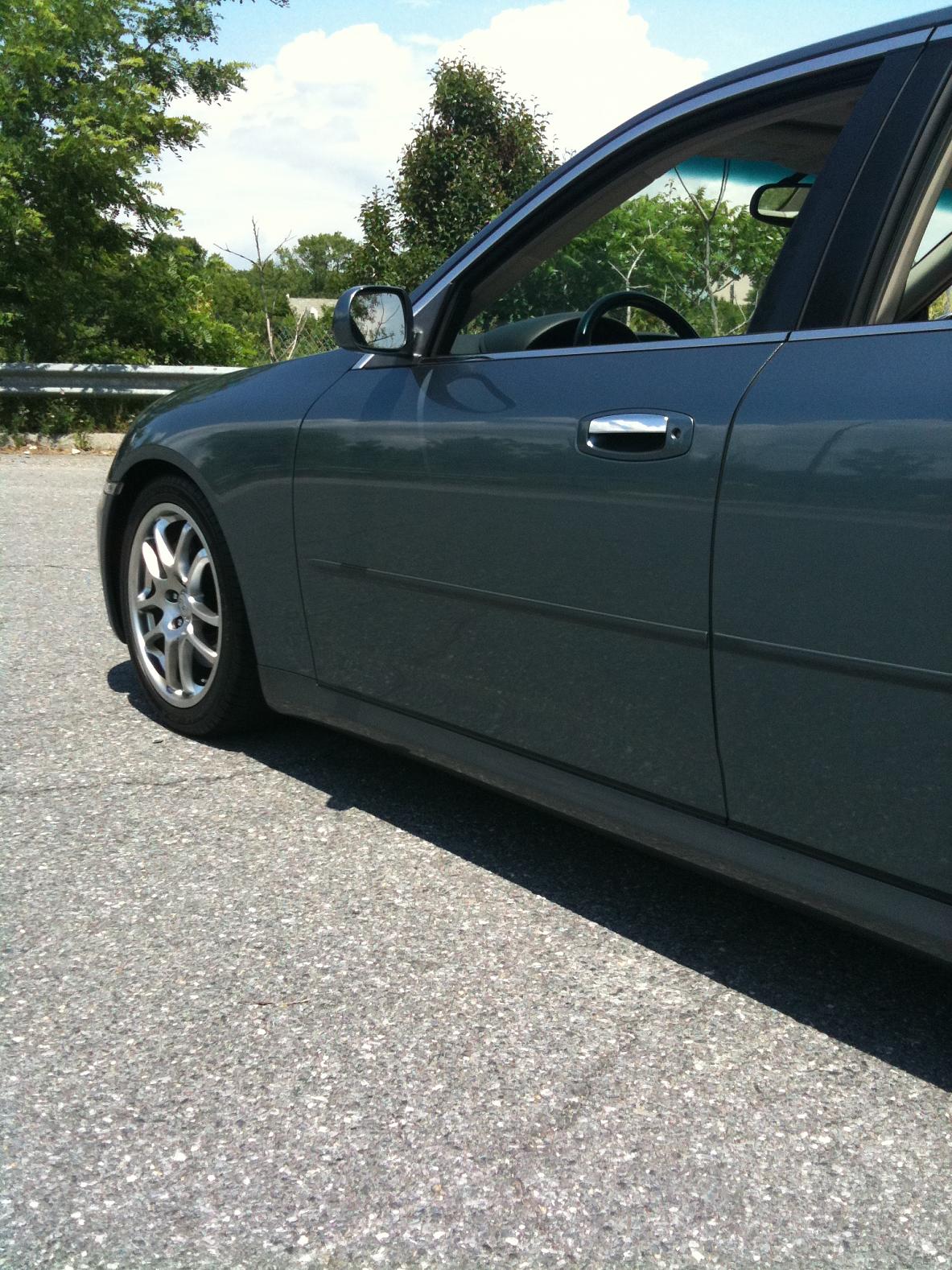

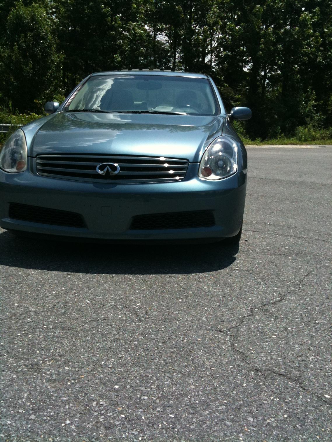

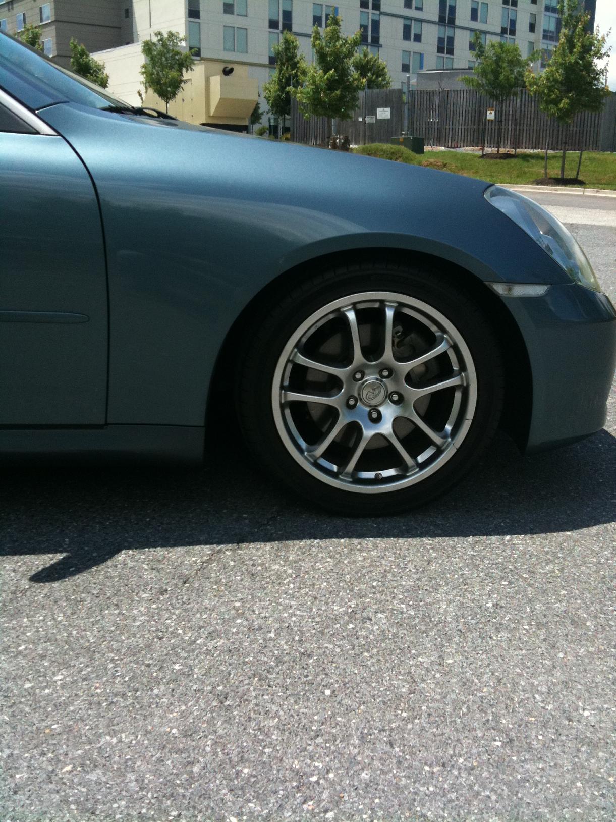

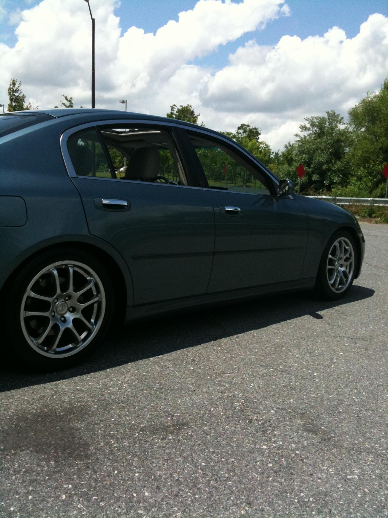

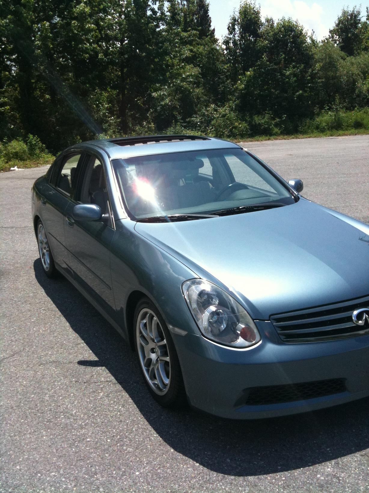

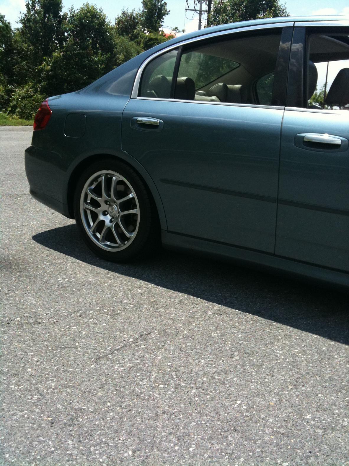

The fronts a little less than a 2 finger gap and the rear is a 1 finger gap
Attached Thumbnails G35 Sedan Suspension Picture Compilation Thread-stechs-001.jpg   G35 Sedan Suspension Picture Compilation Thread-stechs-011.jpg   G35 Sedan Suspension Picture Compilation Thread-stechs-012.jpg   G35 Sedan Suspension Picture Compilation Thread-stechs-008.jpg   G35 Sedan Suspension Picture Compilation Thread-stechs-003.jpg

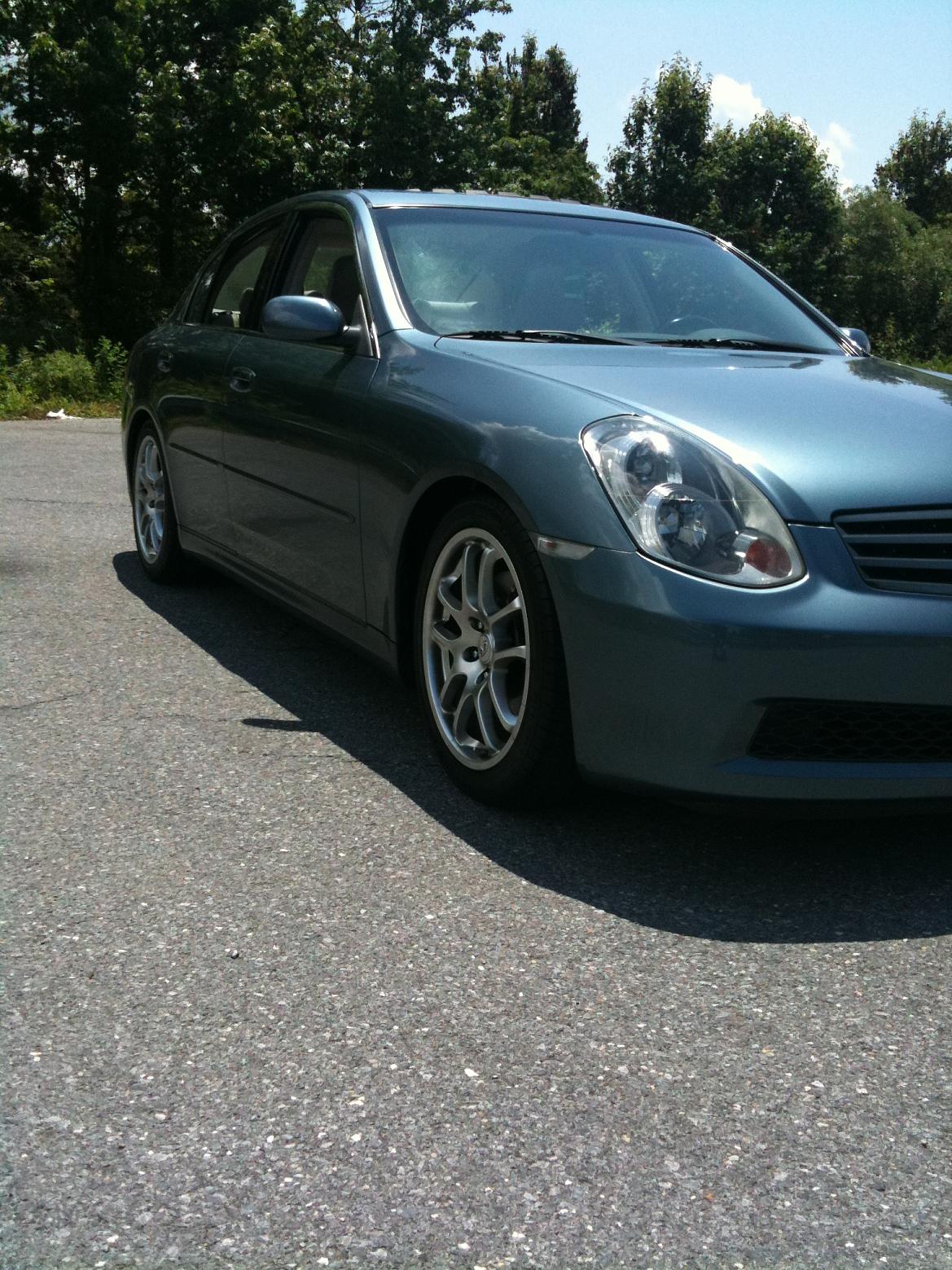

I'm gonna try to invest in a digital camera; this iPhone doesn't quite cut it anymore...
