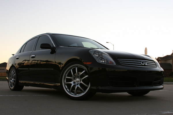

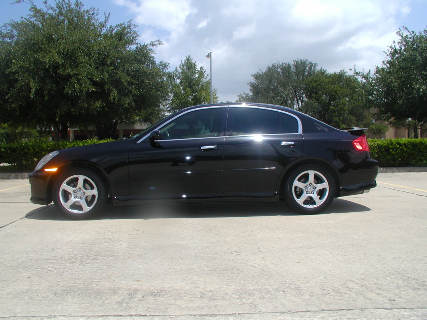

before............................................ ...after
Everyone brought up some good points. I think we all in a agreeance that the coupe 19s are one of best stock wheel out there for a mainstream car. While I love the way they look to death, the over sensitivity and dartiness is starting to get annoying. I am wondering also how much the wheel offset plays a part. I guess a good test might be to compare the stock sedan 17s against the staggered setup of the stock coupe 17s. Does anyone have this setup?
