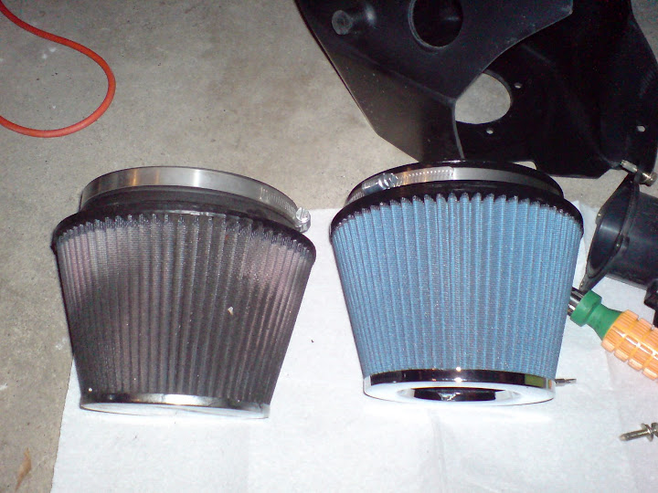

Hi all,
I have a Stillen intake and have two cone filters (the k&n that came with the intake and I also bought a pop charger cone filter). I've read many posts about people putting on too much oil when they clean and re-oil the filter and then it damages the maf, etc. Since I have two filters, I can clean one and let it sit and dry for a few months if it takes that long. Question is, how are people putting too much oil? Are they trying to do it on the same day and then put it back onto the intake without the oil drying up?
If I would to wash and re-oil it and just let it dry for a week would I guarantee I won't have this maf problem even if I oil too much? Time is not a problem for me but I just wanted to know if giving it more time will the oil dry up or I will still end up with maf problem if I oiled it too much?
A quick picture of the last time I swap it with the new popcharger.
I've had the popcharger in for 2 yr and 4 months with about 12k miles.
Thanks...
