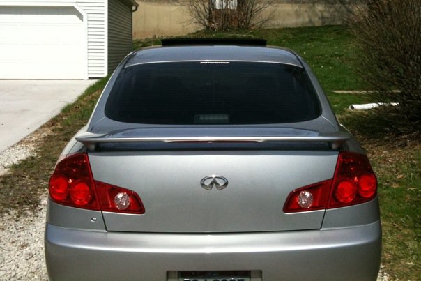

I just did this last week, if you dont have a heat gun, just make sure the sun is hitting the trunk for a while.
i started around noon and it was maybe 70-75 degrees outside. Used fishing line to saw the letters off, then soaked the adhesive with goo gone waited about 5 minutes and used a credit card to scrape some of the adhesive off, then repeated. ( an no the credit card didnt scratch the paint)
worked fine for me, just took some time, and patients
