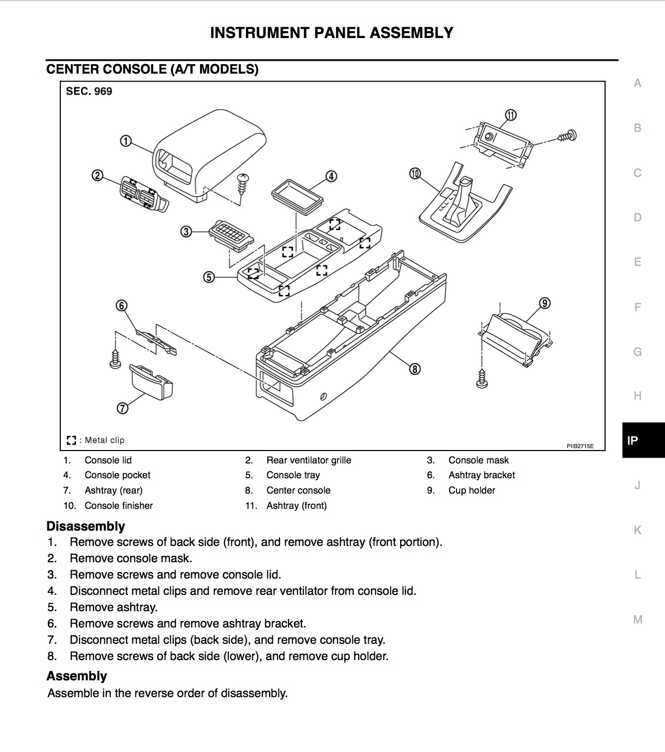

Here's the page from an '05/06 service manual (which you can find here: http://www.nicoclub.com/FSM/G35/Sedan/2005_G35_Sedan/ )
It doesn't show the bulb, just how to get to it.

Help. This shift indicator bulb in the console has been giving my wife trouble for a while. Smacking the console lightly would bring it back but now it is totally out. I was able to get to it and replace it with a Sylvania type 74 bulb(only brand available locally). Still doesn't work! Read that Sylvania won't work because of the length of the socket portion is too short but it looks to be the same size as the one I removed. What could it be?

Well, turns out the bulb is fine! After trying to flip the new bulb around and still not getting light I put the old bulb back in and wiggled some of the wires around. It went on for a few seconds. I spent another couple of minutes wiggling them again to pinpoint where exactly the loose connection is. Could not get it light up again. Damn. If it's only the socket harness then no problem to fix as long as I can get a new one. If it's somewhere else in the other harnesses down there then I'm out of my league.
