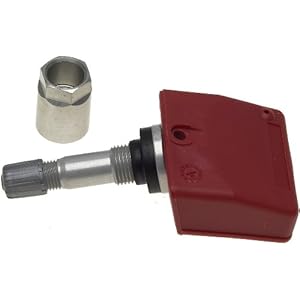

so the insane heat has nothing to do with it?
also, where are the sensors located on the tire? are they in the cap?

They are internal, but part of the valve stem. Take a look at the stem and you'll see it's metal. Inside the wheel is a small box.

Looks something like this...many different makes so looks vary slightly.

does the light flash when you first turn car on for about ten seconds or so. if so u have a bad tire pressure sensor. the dealer can tell you which one.if the light stays solid when you first start the car. you have a tire with low air. i would recommend running 37psi. that is what we at the nissan dealer i work at
if you look at the valve stem and it is silver and feels like metal it is a tpms. if it is black and is move around and feels like rubber. it is a regular valve stem. the only way to replace them is to get the tire off the wheel. then get reprogrammed at the dealer.
