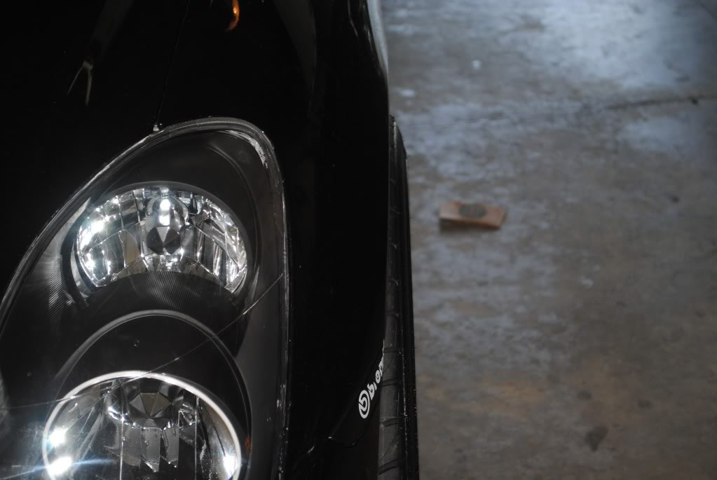

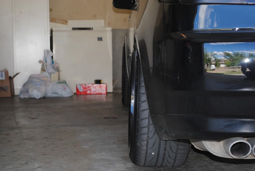

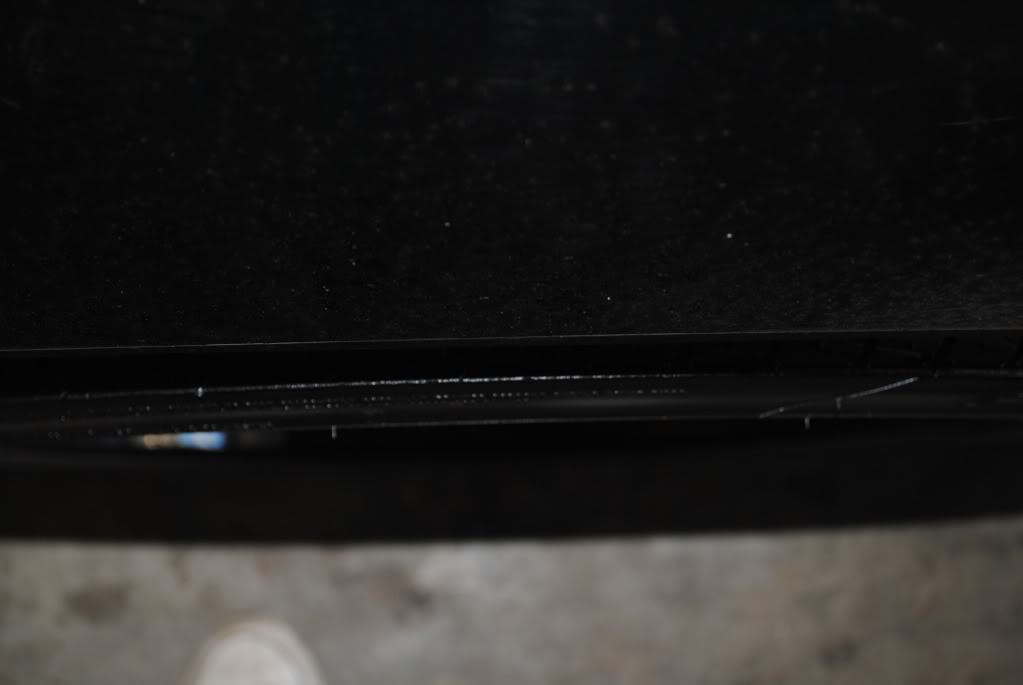

wheel specs Front - 9" +14 Rear - 10.5" +24, its lowered 1.5" all around. i dont want to go much lower because our roads are **** where im from.

you fronts look fine .... whats wrong with them ... if your not lowered that much and want to stay within spec , stay with 350z specs and you will be ok .. are your rears rolled flat with that setup ?? IMO the whole car (camber) looks fine .. hell i wish my camber was like that im like -3.4 rear and -3 front lol if you go lower :-) you will have natural camber front and rear and that 1/2'' up front will go away .. yea roads here in florida sucks A$$ but its ok a little scrape never hurts anyone :-)

they stick out a little to far, they also rub on most bumbs, the rears are just rolled flat.. i dont have any issues in the rear with rubing. i want that wheel to be a little more tucked in the front and this should get rid of my rubbing issue.

How about some side view shots?
And I'd suggest losing the brembo sticker on your sidemarker but that's just my opinion.

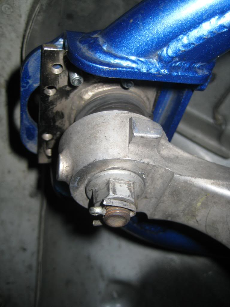

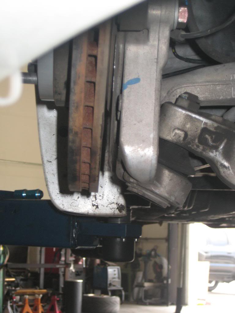

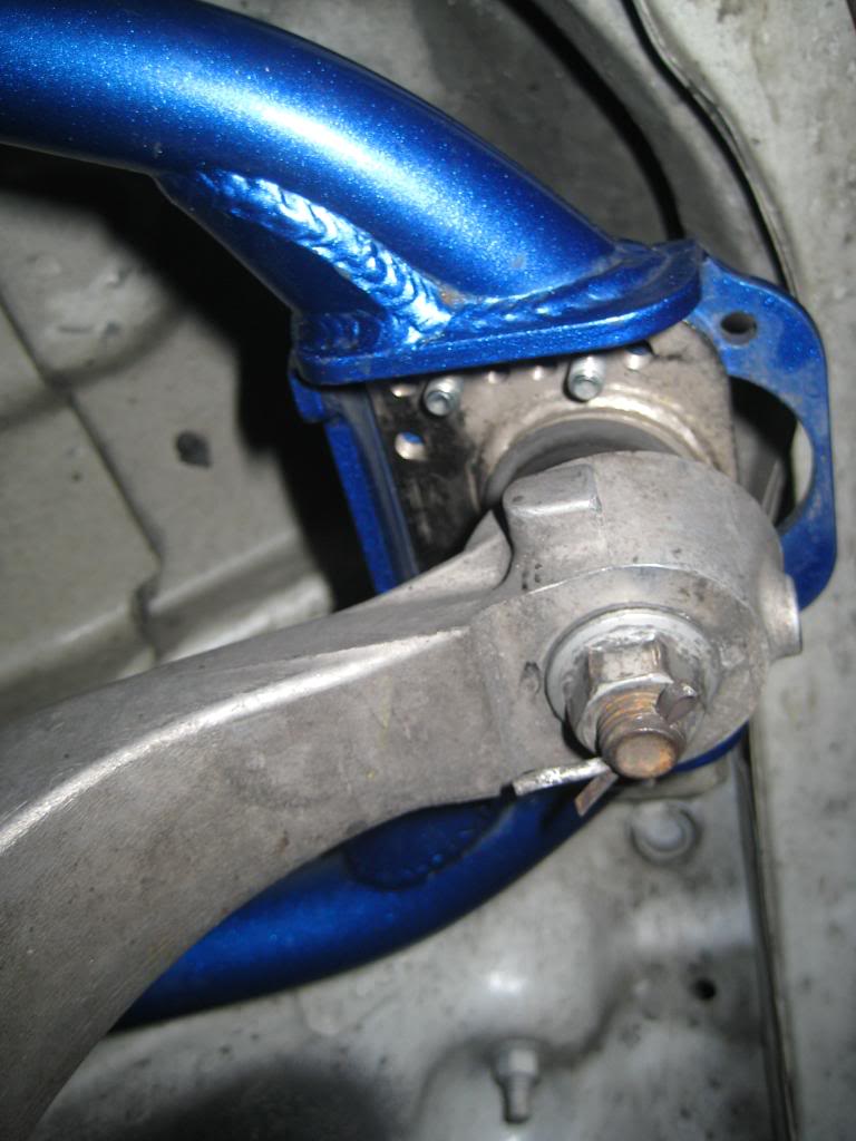

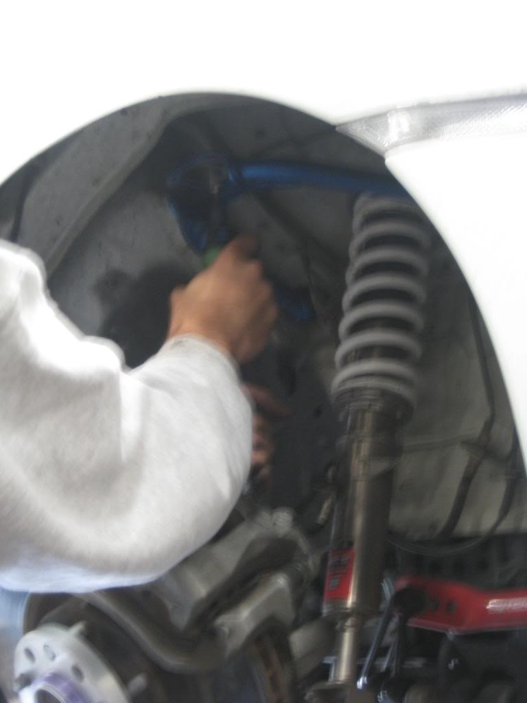

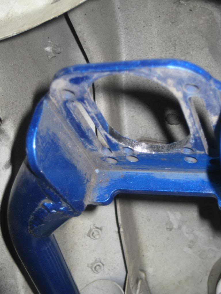

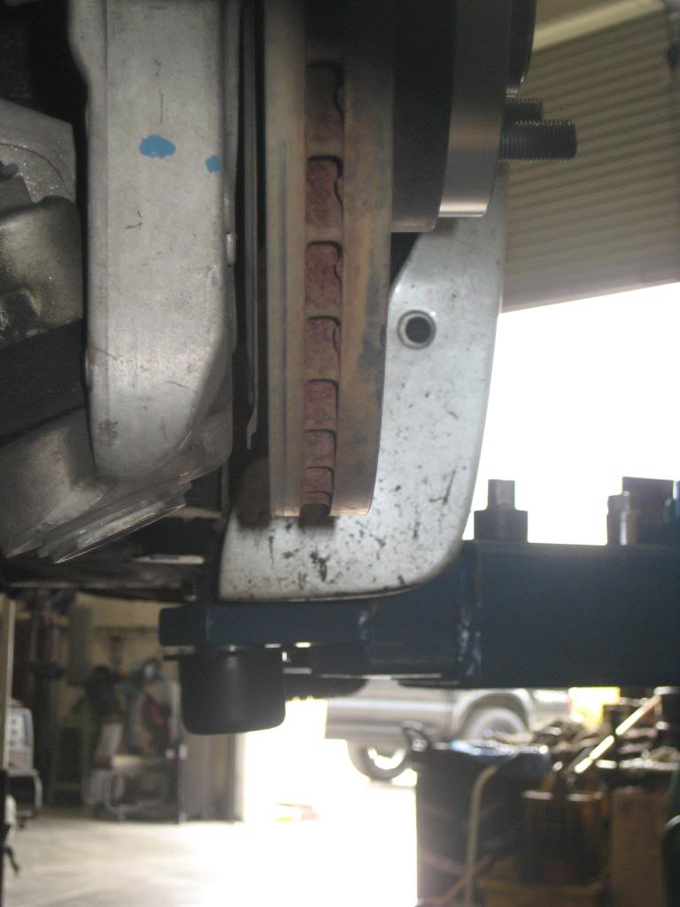

SPC's will give you the adjustment you need as will 350 Evo upper A arms. I use Cusco and had them modified to give me even more camber adjustment. Without the modification I got -4.1 camber and with the modification I got -4.7, but I can squeeze it out to -5 if I really wanted to.
If you're interested, here's what I did to get the additional camber. Not sure if this can be done with your Kinetix, but if so it will save you some money, just labor costs.
How pretty much everyone's upper A arms look
In progress modification
Ahhh....nice. Another 0.6 degrees of camber achieved.
Before upper A arms installed
After upper A arms installed
Basically I had the inner part shaved off and then had the plate flipped.
