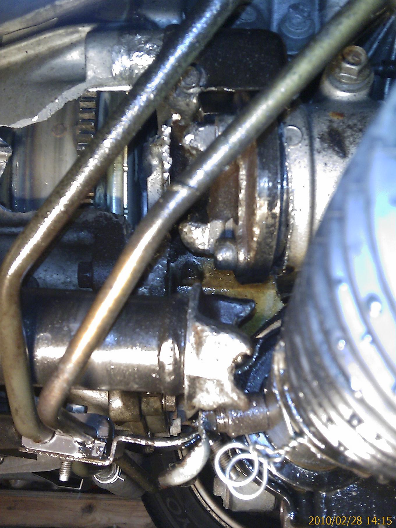

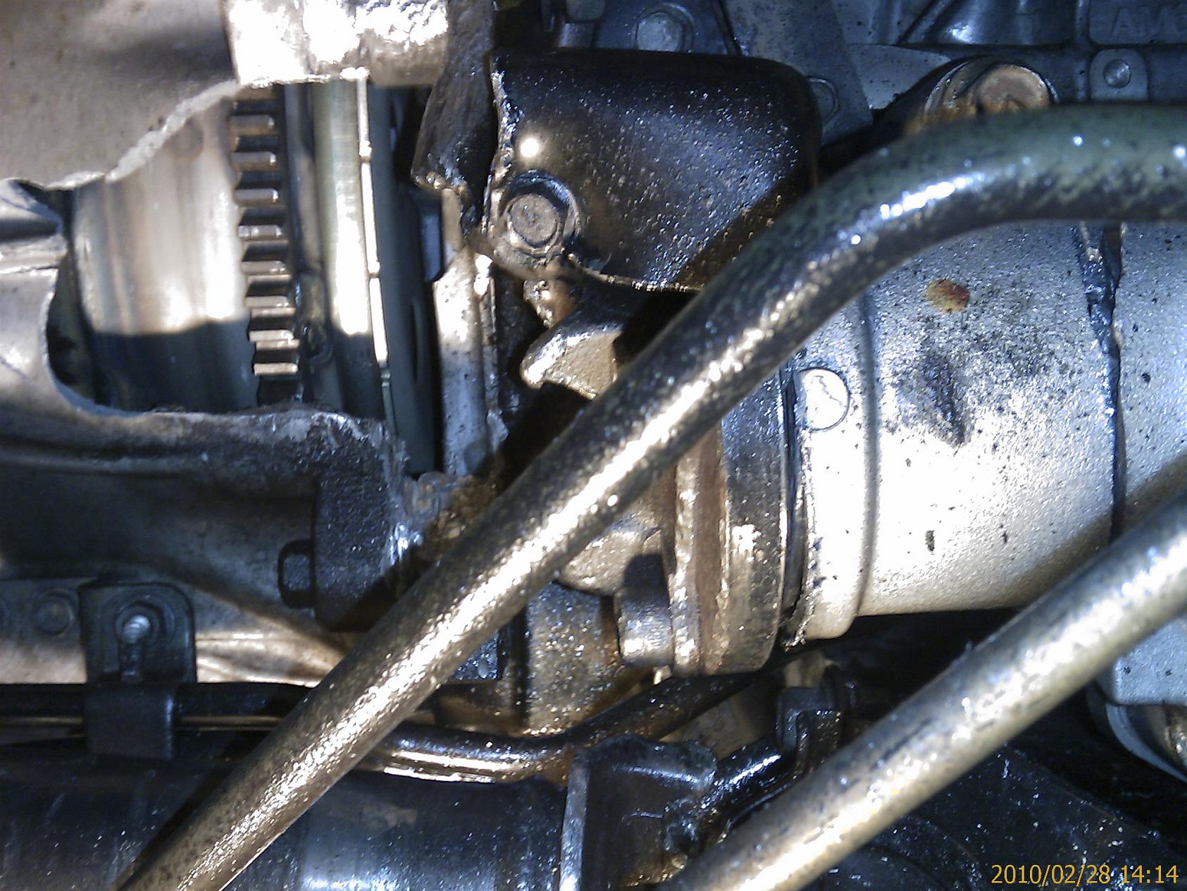

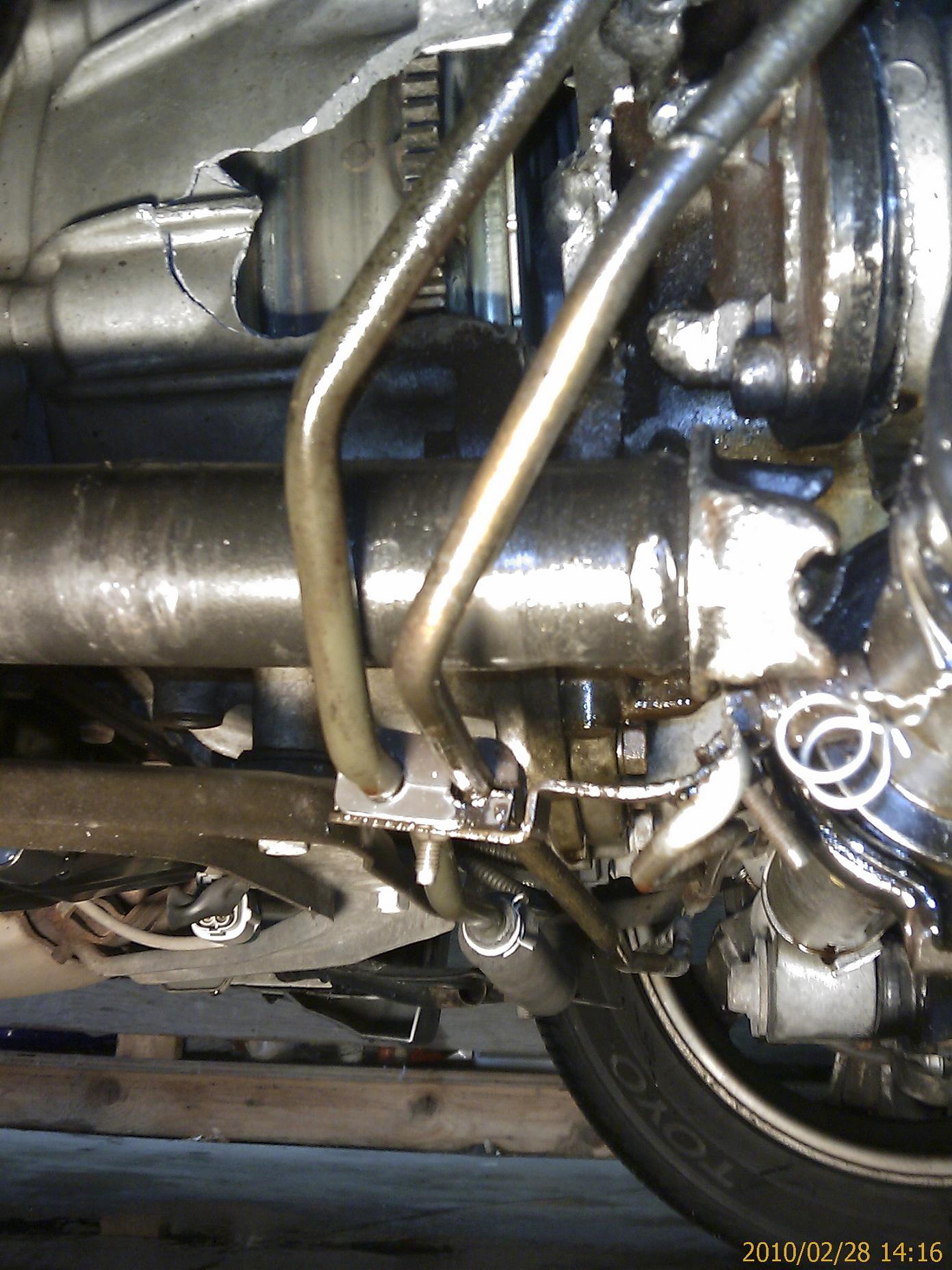

Be carefull !!
Do u hear any banging sounds @ low speeds ? When AWD is activated and goes away after 20 mph or so ? The fact that your burning out tells u AWD is not working correctly. Are u getting a AWD MIL on your dash ? I can tell u from xperience that if your U joint goes on the front prop shaft it will not throw a MIL and this will happen.

Originally Posted by StratagemII
Be carefull !!
Wow, that is crazy! did you make a thread with more detail about this? I would love to hear more about this. Do you have any other pictures?
Old Sep 5, 2010 | 09:30 PM
StratagemII's Avatar
Joined: May 2006
Posts: 57
From: Poughkeepsie NY
No, didnt think other g35r's would want to hear about this
Exactly what would u like 2 know ?
Yes really all the same shot just from different angles
kinda painfull 2 look @ thats my transmission with the hole in it but if it can help another G/Z owner I can live wit that
Attached Thumbnails Differential question..-imag0027.jpg   Differential question..-imag0025.jpg
