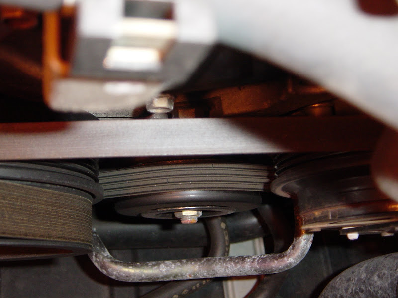

Hi,
Finally, got around doing the spark plug oil pooling check. Anyway, while at it, I check the belts. Both belts have small cracks. Should I swap them out asap? My car is an 05x with 38k miles.
Thanks...

Seems pretty minor to me. Mine are way worse. I've never heard of anyone's belts snapping before though. Just squeaky.

theyre really easy to change out... but i dont think its too bad unless you see maybe chunks of the rivets missing.

04 and 50k. The tech's told me it was cracking last winter. Still havent gotten around to changing it. I know everyone says its easy but the DIY video makes it seems a little complicated. I guess I wont know until I try.

you don't need a torque wrench for serp belts. and i replaced a local guys belts bc they snapped when he went to pull out of his apt. complex

I replaced mine as soon as I noticed cracking. Figured it was time. Only 31K miles but five years old.

doesn't look bad to me. fwiw, belts aren't that hard to change and you don't need a torque wrench.
remove undertray, break loose bolt on each tensioner pulley, loosen tensioners using socket & extension, swap belts, tighten up tensioners (check belt tightness as you go), tighten up the bolt on each tensioner pulley, reinstall undertray, drive over to your favorite watering hole or strip club

I run my belts with cracks like that for past 30k miles
