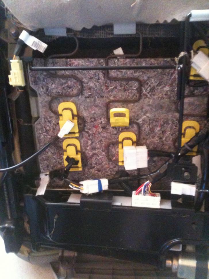

w/e you have time to do and label. I've been waiting for a local deal to pop up. Been holding back for 05-06 model. Good thing about stone is either stone or black can work for me.
from the other 2-3 threads i read. The pass side normally plugs right on up and you need about 3-4 wires to repin or splice on the drivers.
Both side heater connectors and airbag harnesses should be plug and play. Its just the power on either.
Does your sedan harness plug into the coupe seats? So all it needs is repinning or do you need to splice around it.

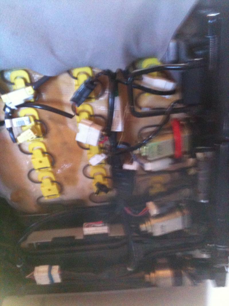

i asked a seller a while back to send me pictures of the connectors so i can figure out a possible splice points. This is what i have and i'm trying to make sense out of it.
I dont know which one is what. obviously yellows are SRS
there should be 6pin connector x 2 for the driver side of a sedan and just a 6 pin connector on the pass.
1 6pin for up/down recline/decline
1 6pin for tilt
Attached Thumbnails Issue with coupe seat swap-img_0767.jpg   Issue with coupe seat swap-img_0766.jpg
