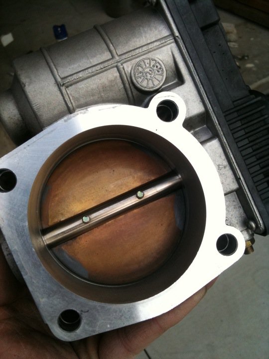

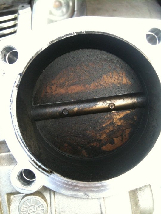

A couple days ago I took off the battery terminal to attempt to fix my radio (CD ERR FO) problem.
After replacing the battery back and starting the car, she would die right after ignition...unless i gave her a lil gas from initial start.
I looked on the forums for a solution and I came upon two: RESET THE IDLE POSITION AND CLEAN OUT THE THROTTLE BODY. Upon reseting the idle position, the G starts fine when its cold. BUT the problem comes back when the she warms up. I then cleaned out the TB and the problem is ultimately fixed.
Long story short, when the reset does not work, clean the TB and you should be set. thought id share my experience
CHECK THE PICS
Attached Thumbnails Dies after ignition-solution-188487_673311092162_15109047_36154861_2011364_n.jpg   Dies after ignition-solution-199165_673310852642_15109047_36154849_5466219_n.jpg

What did you use to clean out the throttle body?
Old Mar 28, 2011 | 11:01 AM
seebas's Avatar
Joined: Mar 2011
Posts: 23
Some use brake cleaner but I used carb cleaner from Autozone and a toothbrush.
Afterwards, hit the inside with some wd40...then wipe it all done with a microfiber cloth
If u want to get **** about everything, make sure that All contact points from every piece (TB-air filter) is clean, residue free and with A guranteed seal
The person I got the car from didn't do any cleanup maintenance and caused a massive buildup of sh*t I'n the TB...as u can see from the pics above
