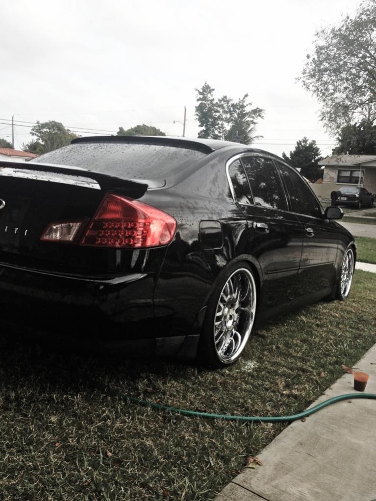

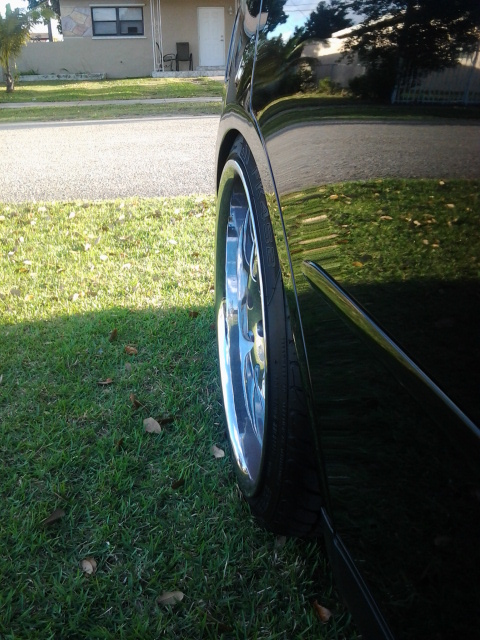

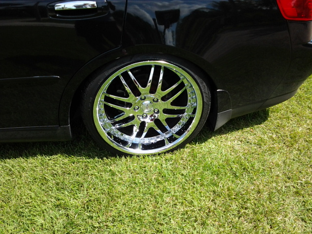

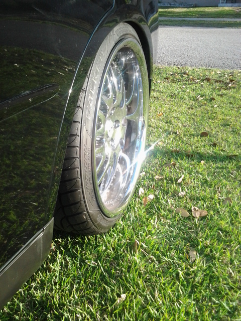

for some reason i notice that my rear wheels is pointing out ward .
my rear driver wheel is pointing out the whole wheel itself..
and on the other side is normal and stragiht
i am dropped on teins coils basic
and i do have camber spc rear
i havnt done anlignment
and for some reason also
when i dropped my car
it doesnt dropp even
1 side sits a little higher then the other side
the driver rear sits higher and points out
rear passenger sits lower n sits straight
any ideas
or ways to fixs this ?

Toe adjustment needed. Part of getting an alignment.

With a toe adjustment, yes.
Did you get the alignment redone after installing the arms and toe bolts?

When you lower a car, your tire/rim will camber in (negative camber) and this will also cause toe to come out (toe and camber affect each other). That is why your tire is sticking out on one side. An alignment will get you back into spec. Also, having your toe off like that will wear down your tires fast (a lot faster than just having negative camber).
A lot of cars are off and it becomes more appearant when you lower a car. Since you have coils, you just need to adjust one side to match the other in height.
