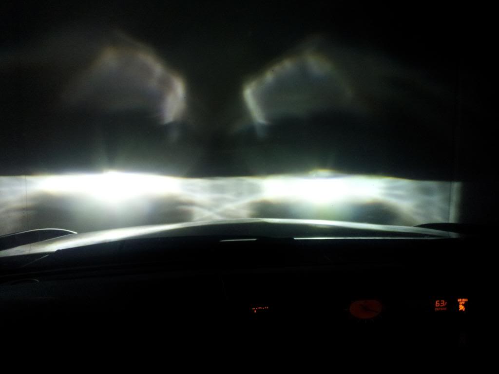

I just installed the projectors and how come the visibility is awful. Like the projector would scatter the light everywhere but the front
That cutoff line is terrible for a projector. Are these aftermarket? If so, what bulb do they use? A real D2R bulb, or a rebased halogen bulb? Looks like whoever designed them didn't engineer the focal point correctly inside the projector.

Yeah d2r bulbs. Im returning that junk

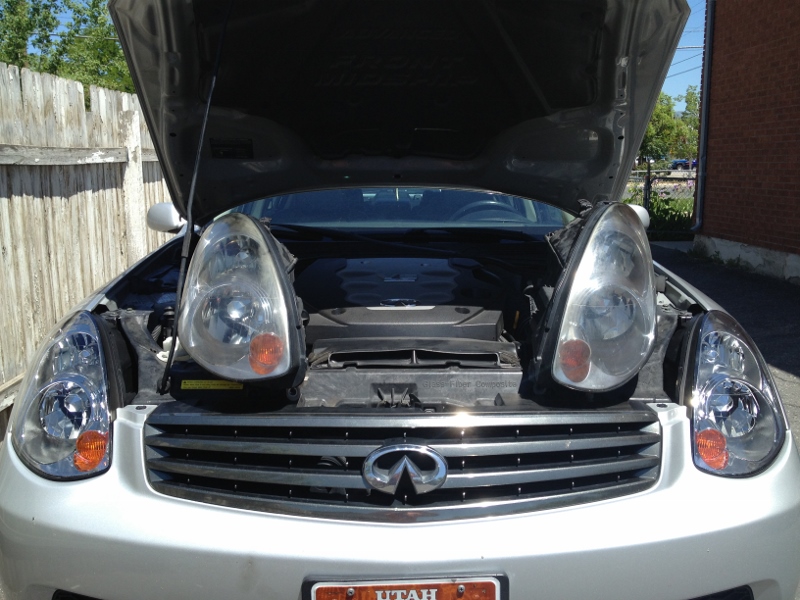

Here are a few pictures. I'll try and get more of the new ones installed this weekend.
Old headlights, and new ones installed.
Also, I put some clear silicone along the gap I mentioned earlier. I did a water test today with a hose and there isn't any water in the headlights. I don't know if the silicone made a difference or not, but it was worth the peace of mind. In looking at the stock headlights there is a gap in the same spot as well, but on these headlights the gap was a bit bigger. So it may not be an issue at all.
I'm going to check my headlight alignment tonight when it gets dark and adjust as needed. But overall I am pleased with the new headlights. They look a lot better than even cleaned up stock headlights.
