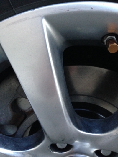

Drivers side front:

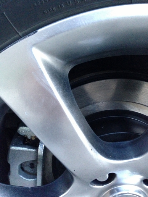

Passenger side front:

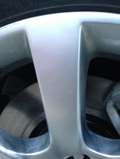

drivers side rear:

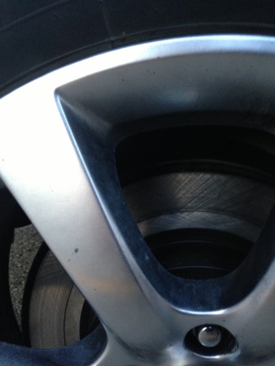

passenger side rear:

The lines in the last photo are a cause for concern as im sure they will cause ridges on the rotor in the long term.
This is the condition of the rotors pads after basically just 20 miles.
What do you guys think?
I'm going to take it in tomorrow to have the rears looked at again and get to the bottom of this scraping sound.

20 miles? I'd probably let them go a bit longer. But seeing as you had a shop do the work, i'd take it back.
My two suspected causes.
1 slide pins not properly lubricated not allowing the caliper to self-center after brake application
2 normal pad surface irregularities that will disappear after some wear from hard braking.
I've done plenty of brake jobs myself and usually it's #2 and goes away after 100-200 miles or so. But I usually recheck for #1 as that issue is much cheaper/easier to deal with sooner rather than later. Early on...it's a relubrication. Later on, it may cost you the rotor/pad/caliper

So the basic verdict after today's inspection was #2 as you described.
The dealership is saying that since I used aftermarket part rather than Nissan parts (centric rotors) they're saying that there's nothing they can do. But the technician said that the noise is less than it was yesterday and that the fit between pad and rotor is really close. I guess I'll just drive it 100-200 miles and assess it after that. For now I'm braking like a grandpa but I think ill probably bed them in over the weekend.
