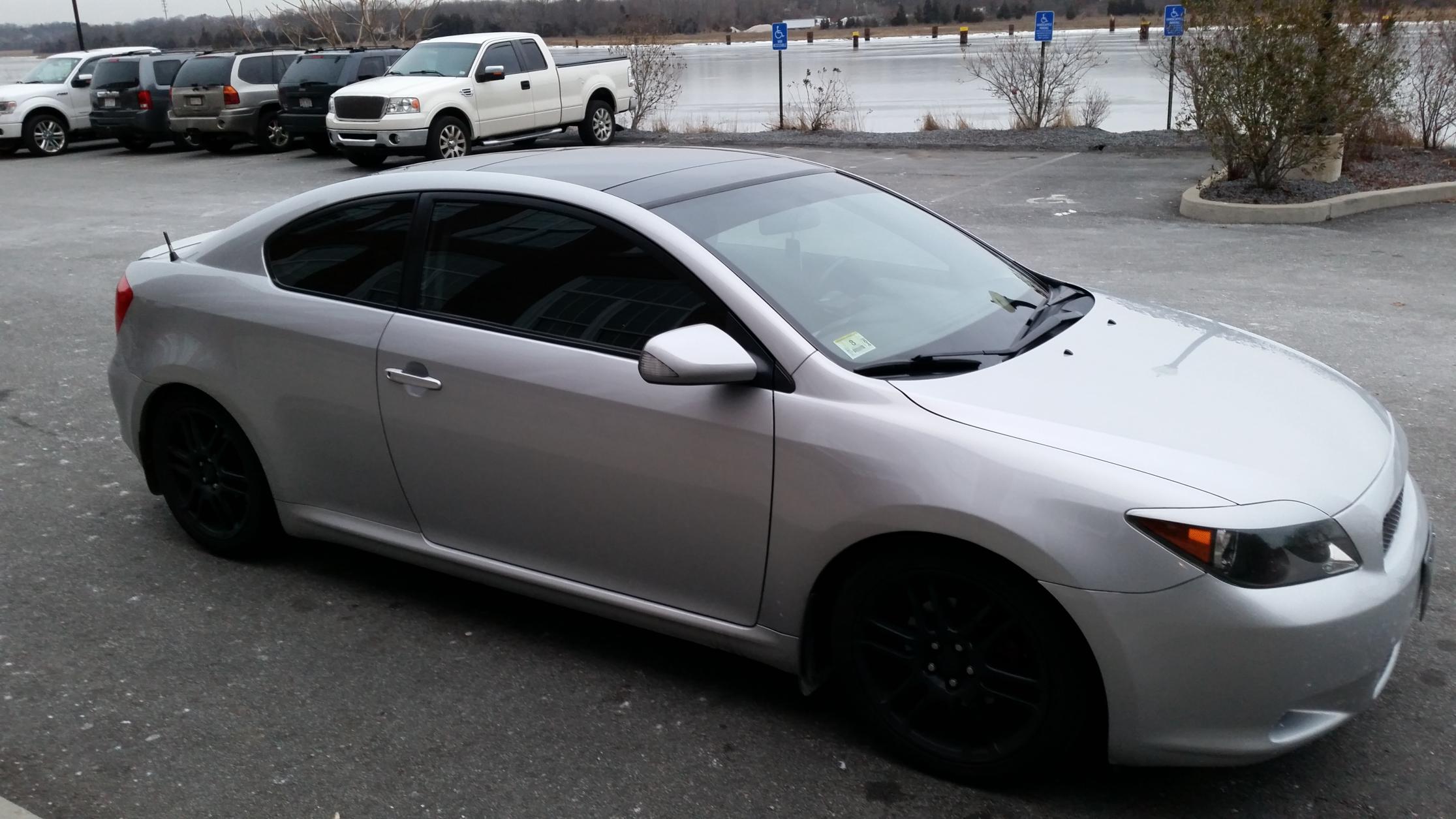

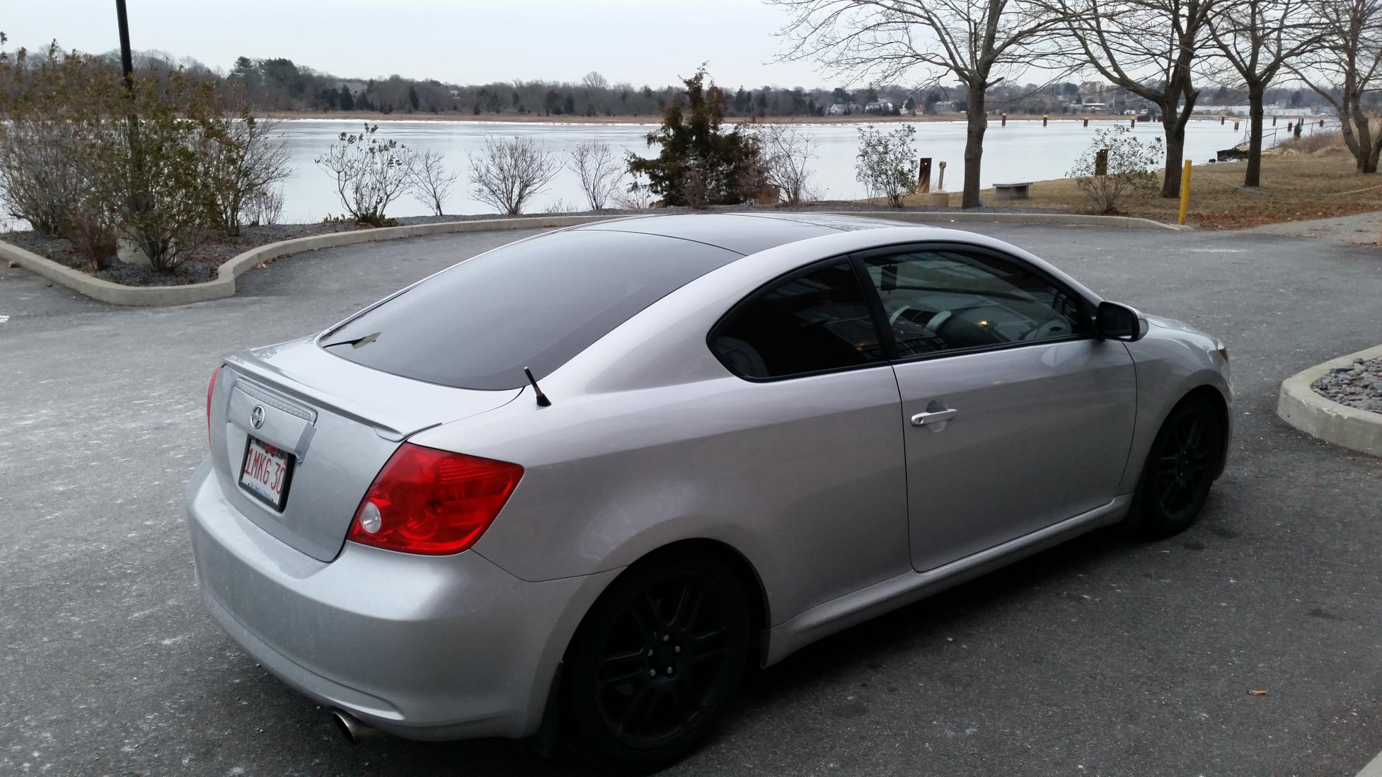

Hey everyone how's it going? My question is. I have a scion tc and it has TRD lowering springs and I like the height it's at because I live in new England. Can't really have that low of a drop. I want to get a G35x 05_06. Haven't decided which year. With just a front bumper lip. What I would like to do is drop it just enough to match where my scion is at I'm not good with measuring and I've tried to figure it out but can't please help I'm just looking for just springs nothing too crazy just needed to know which oNE to get to match the scions drop with an added front lip to the g35X

you post the WORST picture ever to show ride height. A lip and any spring designed for the SEDAN will get you what you want. DO NOT GET the springs for the coupe of 350z.
