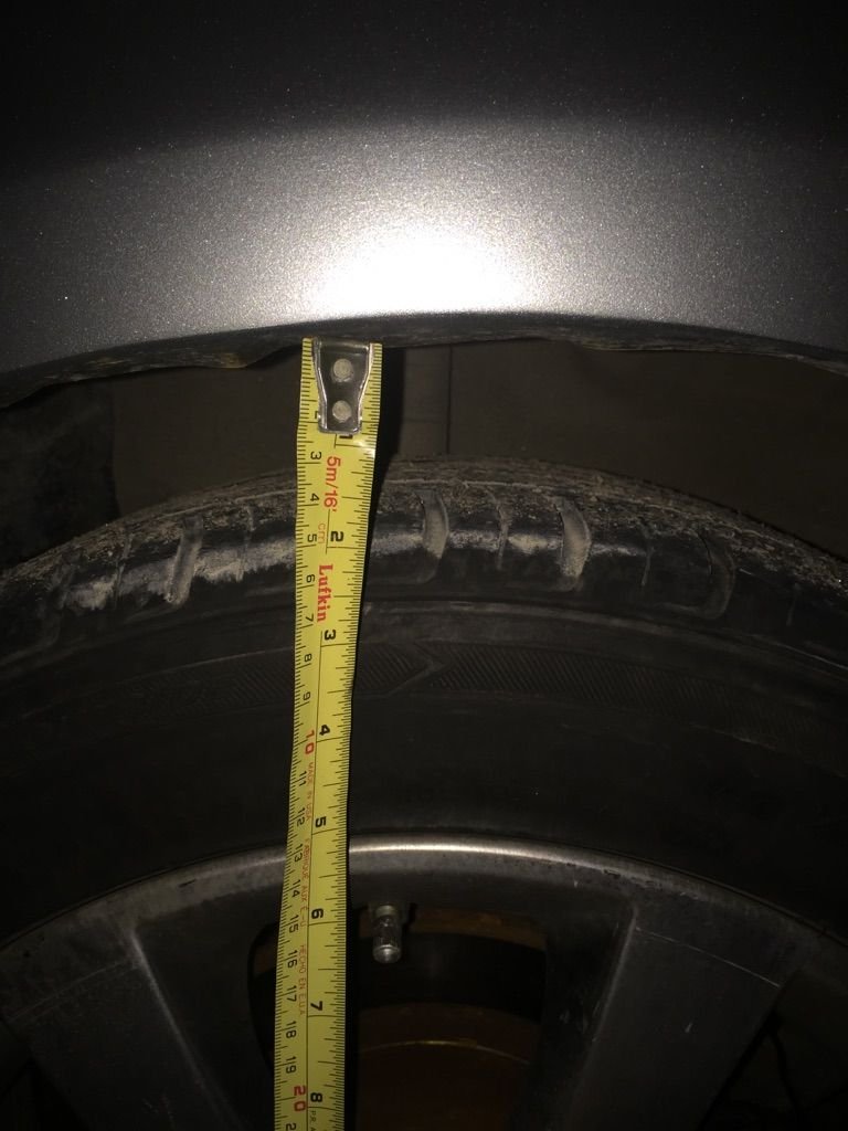

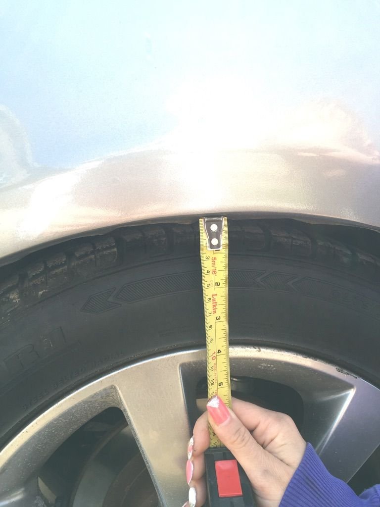

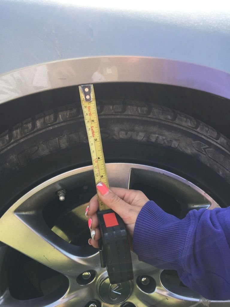

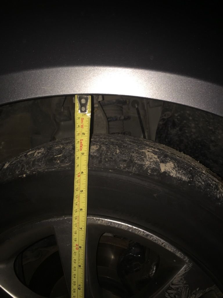

'05
1. Eibach Pro-Kit
2. Approx. 1.5 in the back 1.3 in the front
3. Rides alright, a lot bumpier ride
4.Alignment, needs balancing but thats standard issue
5. Approx. 6k -just recently lowered
6. Knocking in the front, replacing struts soon so well see then
7. OEM wheels
Back before lowering
Back after
Front before
Front after
