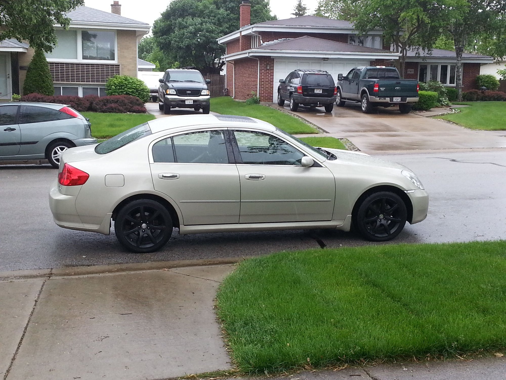

Well I picked up 245-45 r18 tires all around and do loke the look. 225 just seemed kind of small, maybe just comparing the two. I took a pic of one side with 225 and the other side 245. Am now thinking of not lowering it with 350z springs, so I might sell those. What do you guys think? Trying to recover some of my losses at this point. Also will be selling staggered set of 225/45 and 245/45 if anyone is iinterested shoot me an offer. I am in chicago.
These are 245/45
These are 225/45

Different sidewall heights
225/45 = 50.6mm sidewall
245/45 = 55.1mm sidewall.
So the 245's will be a little taller.
OEM tire size is 215/55/17 which is 26.3" in OD.
245/45/18 is 26.7"
225/45/18 is 26.0"
So 245 is a little taller sidewall, but not far off OEM. 225 would be a little closer to OEM. Do you live where it snows? 225 would be a little better for snow.
But as long as all 4 wheels match in OD, you should be fine. Speedo might be a little bit off as well, so try and check it with a GPS device

Thanks for the info. Think I might stick with the 245 and bot lower it for the time being. They are summer tires so probably will switch to the stock 17s in winter I guess.
