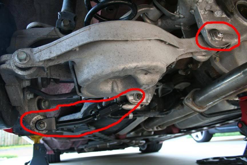

Does the rear tires have toe adjustment?
Do the rear tires on my G35 have toe adjustment?

Yes, but only enough for stock height.

oh weird, but none of the arms on my g35 have any sort of adjustment nut like the tie-rods do in the front end. So where is it adjusted from?

it is the nut circled on the right of the picture. that is your toe adjustment

How in the world does that adjust your toe! i guess i'll have to do it and find out...

The bolt goes thru a cam washer. The washer is an uneven hole and when you slide it in or out it twists the control arm side to side. They sell aftermarket ones (SPC eccentric toe bolts) that give you more adjustment. You drill out an elongated hole (comes with a template) and it has a bigger cam washer/bolt combo.
That picture with the circles is a bit misleading tho. Only the bolt on the far left (where the control arm bolts to the chassis) adjusts toe. That's where the toe cam goes.

ah i get it now. and i assume the arm on the left in red is for camber

Oops! I screwed up! I thought about it for a second (its been awhile) and its the spring bucket hole (the circle furthest to the RIGHT that adjusts toe and needs elongation. The spc kit comes with instructions tho. If you decide to lower it, you will need new bolts.

Yes, the arm on the left is for camber. No adjustment from factory, but SPC sells adjustable arms with turnbuckles.
I was going to say. My factory arm doesn't have that turnbuckle.
