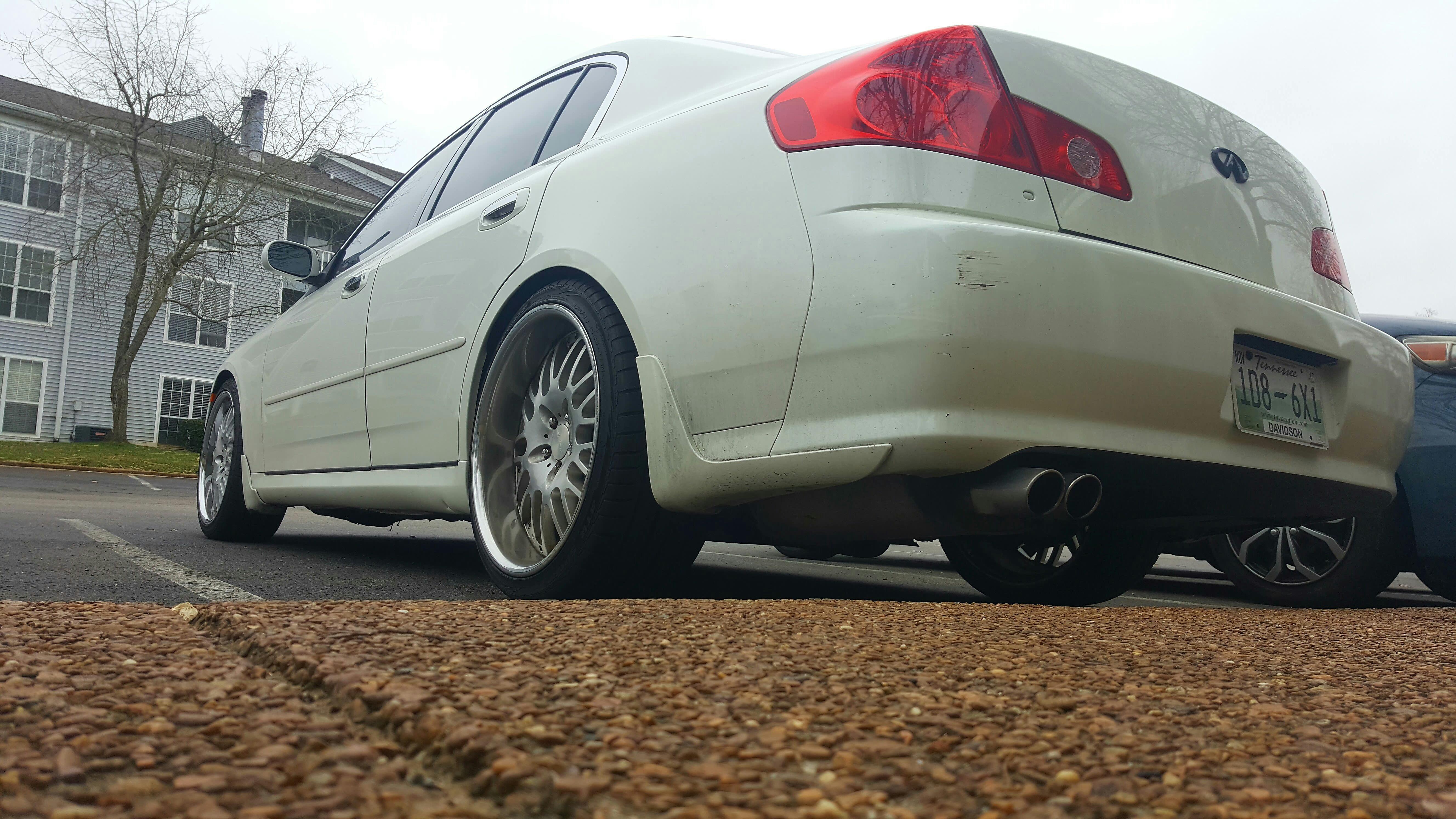

I finally got my 350z suspension installed on Friday! But that was Friday, on Saturday my cel flashed for a minute yesterday then it stopped and now its just on. Im thinking oil probably burned off from the spark plug to create spark. Im going to try to pull my plugs and check for oil on them. I have never done this so God help me. Any insight helps. Thanks.
P.s. she's really dirty.

Well, plug seals are prone to failure at high mileage and cannot be replaced. If you find oil in the tubes when you pull plugs, you might need to replace the valve covers. An easy job but time-consuming because of all the crap in the way.
On the up-side, instead of dropping $300+ at the dealer for new covers, you can get a set of Maxima ones for $88 on eBay and with a little bit of modification you're good to go:
https://g35driver.com/forums/faq-diy...lug-tubes.html
Thank you Yuppy. I'll keep you guys updated
