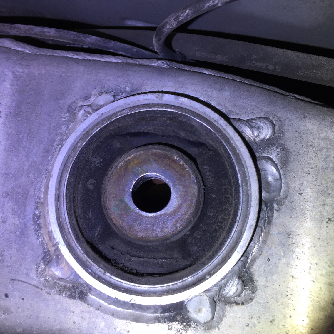

So i checked the mount, the piece is dried out and in bad shape. Looka like a very faint stain of a leak from there. Can you explain how thia would cause acceleration to behave weird?

The differences are not HUGE between a bad bushing and a good one, but it's definitely noticeable. I would bet there are other problems also.
