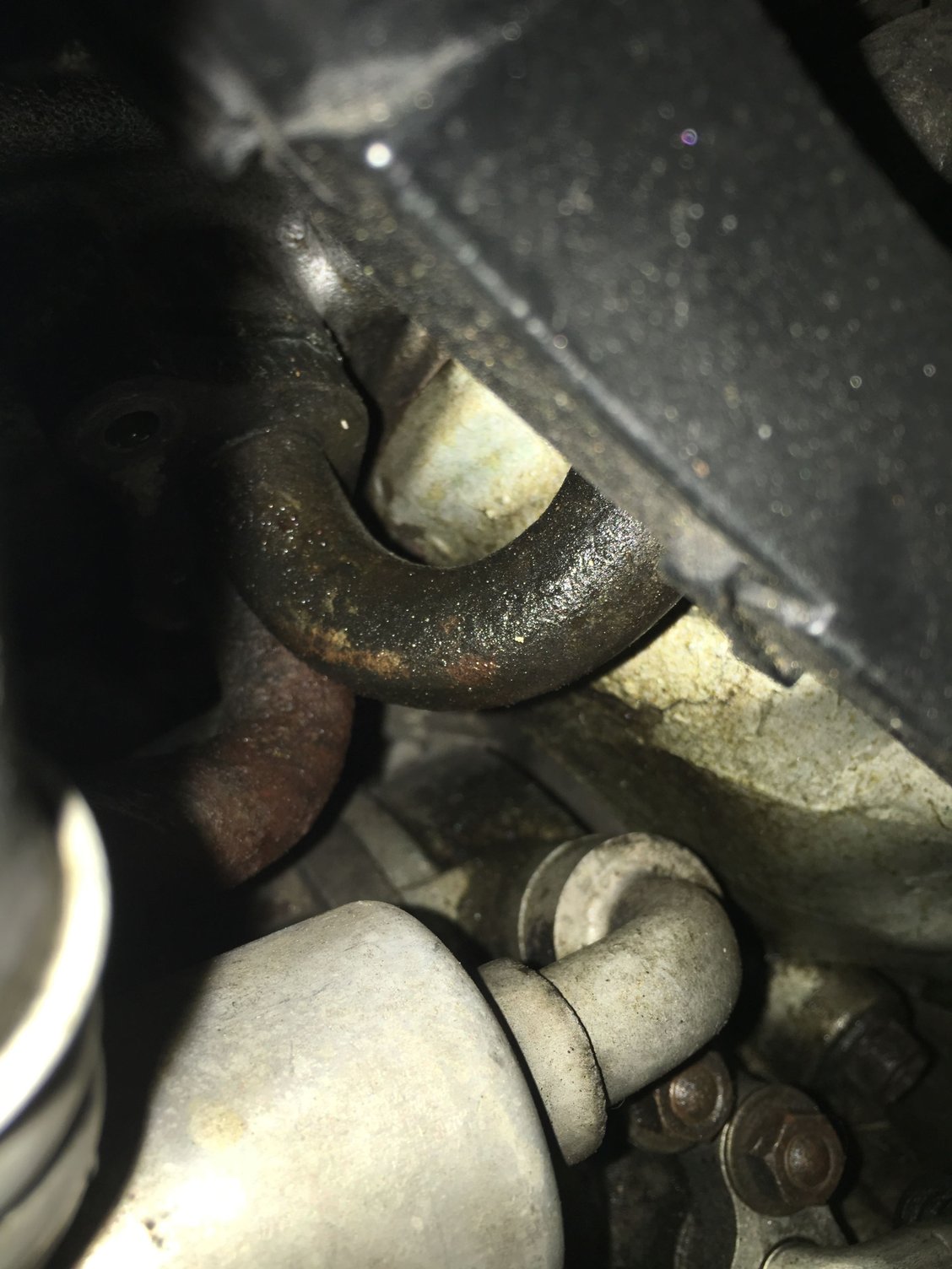

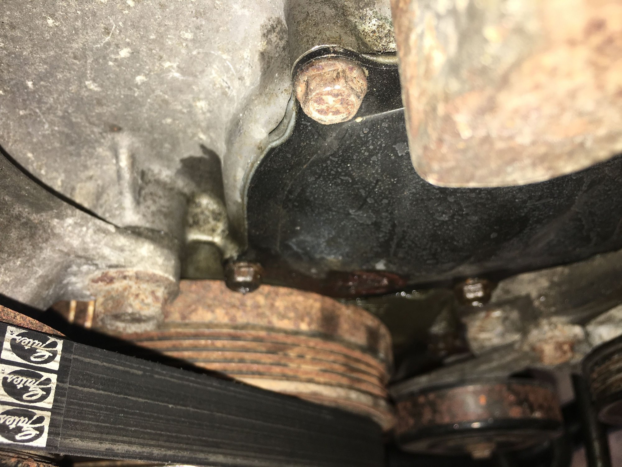

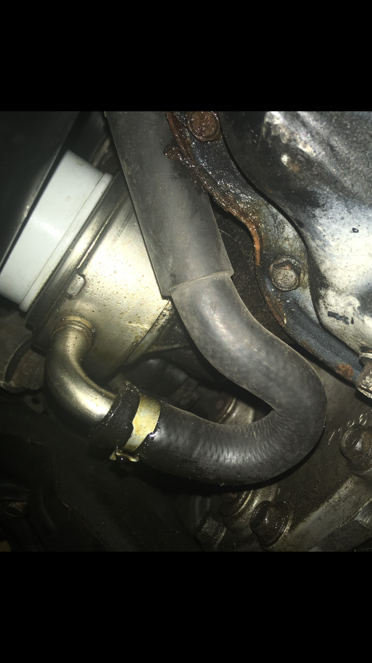

Well I changed out the o-ring for oil cooler totally stopped the leaking.... but my engine coolant is still leaking! However I did get under the car and look to see what was going on This is the water pump cover it looks wet too me I did recently get a new water pump install and was told about the broken bolt in the block ( where it seems to be leaking coolant from) I also noticed that the car isn’t blowing heat anymore....this car is really giving me the blues ughhhhhhhh

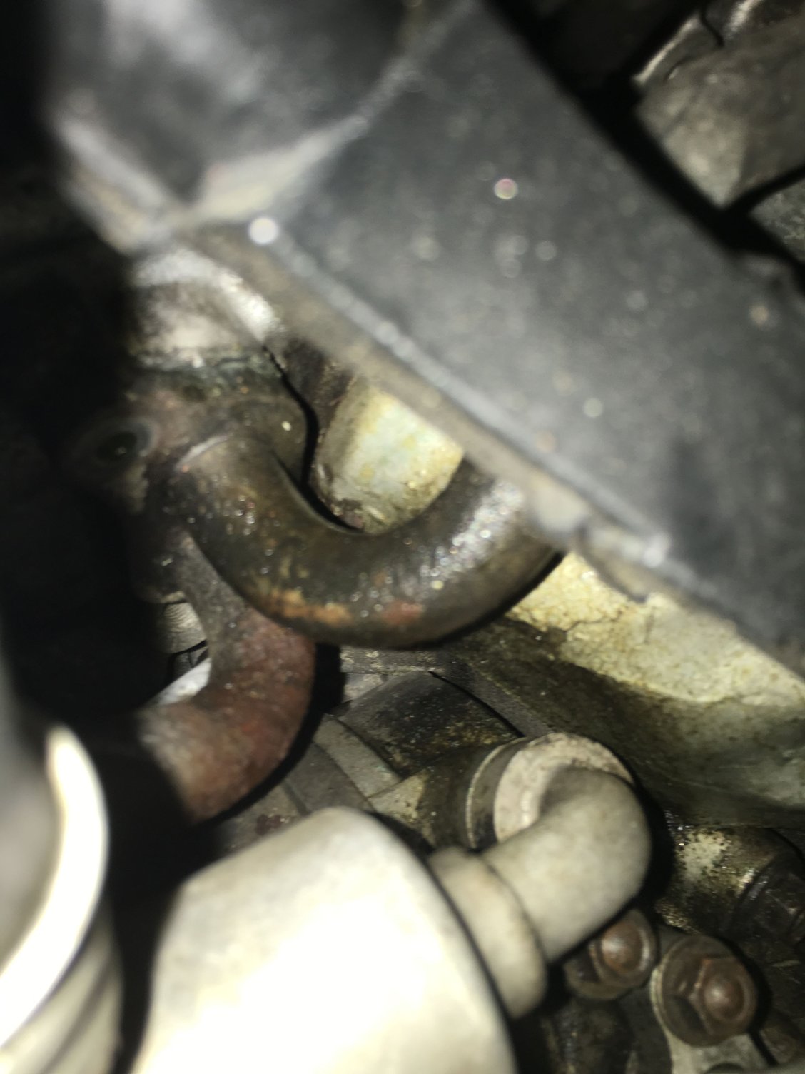

This is where engine coolant is leaking from left side coolant water pipe
This is where engine coolant is leaking from left side coolant water pipe The bolt has broken off inside the block so I need to get the bolt extracted from the black and replace the gasket and bolt and this leak from the side of the engine should stop

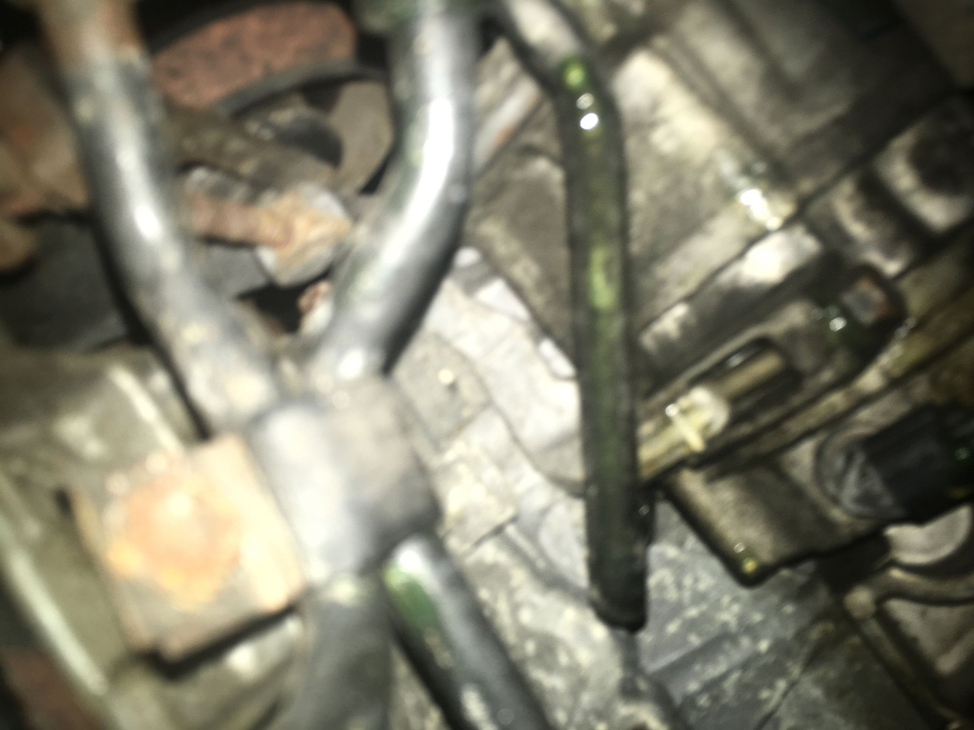

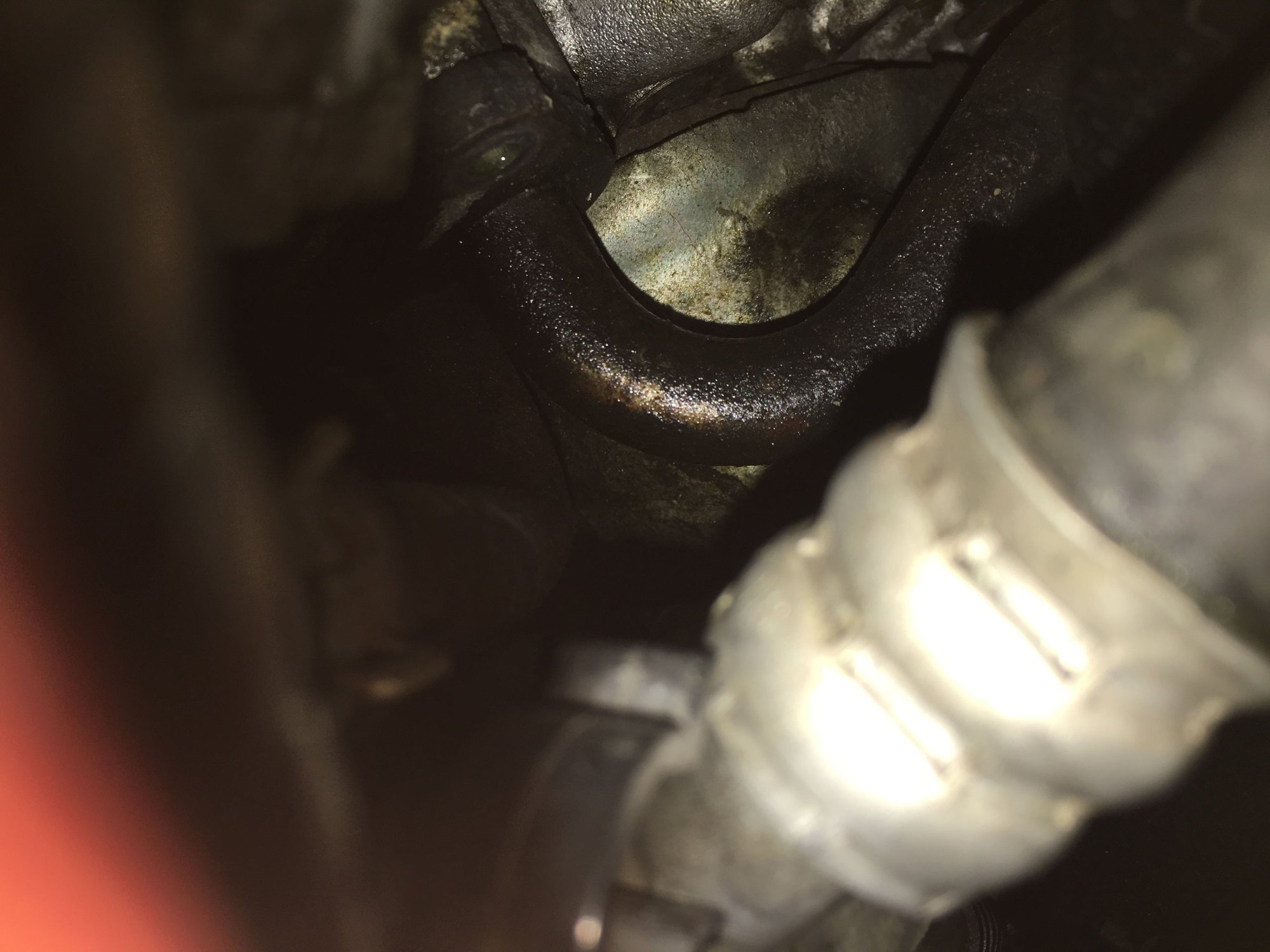

Another pic as u can see no bolt it’s leaking from that hole

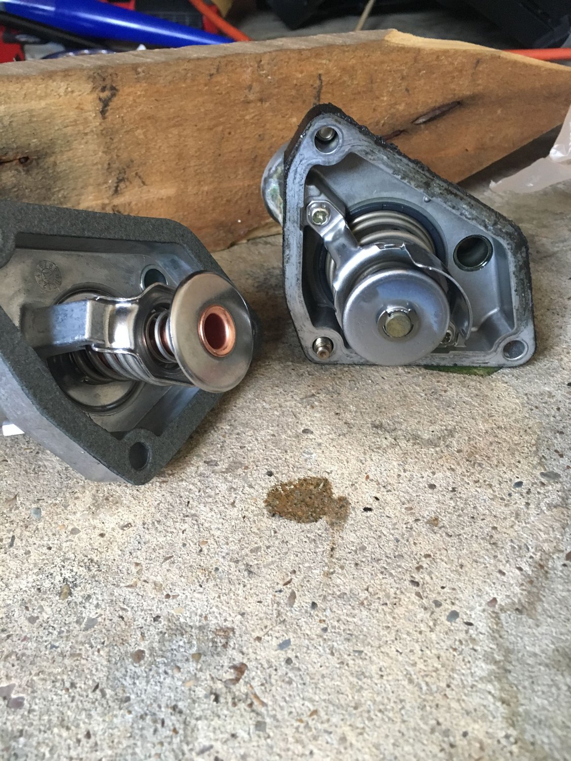

I did change out the thermostat and replace the gasket!

So a mechanic gave the vehicle back to you in that condition?! Bolt extractors aren't exactly rocket science and if you do manage to mangle the thing just drill and tap it out to the next larger size +2mm OR find another location right next to where the flange is missing the bolt and drill/tap another external hole so you can add something to clamp that flange.

okay so I got up yesterday morning took the car to a shop where they could extract the bolt they went from 40$ to 1200$ so my boyfriend was with me yesterday and he was like let’s go to a car shop he goes to all the time so we get up there I tell the guy what the car needs he said to me how do u know that a bolt is broken off in there I told him that’s what was told to me and he asked me well do u have a bolt that fit it I was like yes gave it to him he put the bolt in and tighten it up so basically the car never had a broken bolt it was just missing the bolt on the lower water pipe so now the car drives likes it brand you no more running hot or leaking of the engine coolant... they cleaned off the engine coolant to make sure it was not leaking anymore they top off the engine coolant oh and now my heat is back working in the car also YES!! So in the morning I’m still going to check and see if I see any leaks just to make sure!! They charged me $10 from screwing in the bolt and $40 to top off the engine coolant all in all it took about 1 hour and 45 minutes job!
