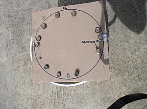

They are out, too. The photo with the original post has two bolts marked Starter.

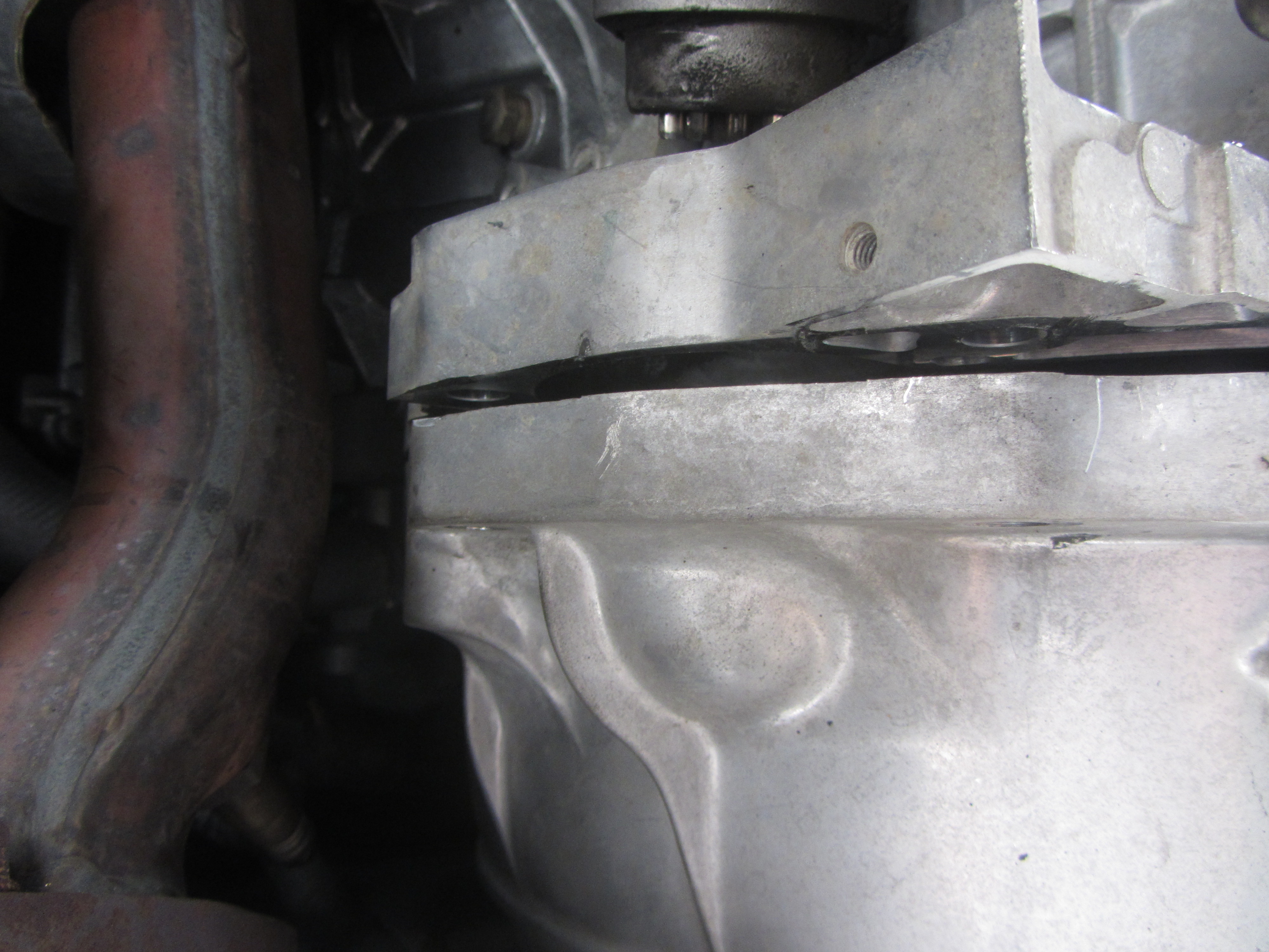

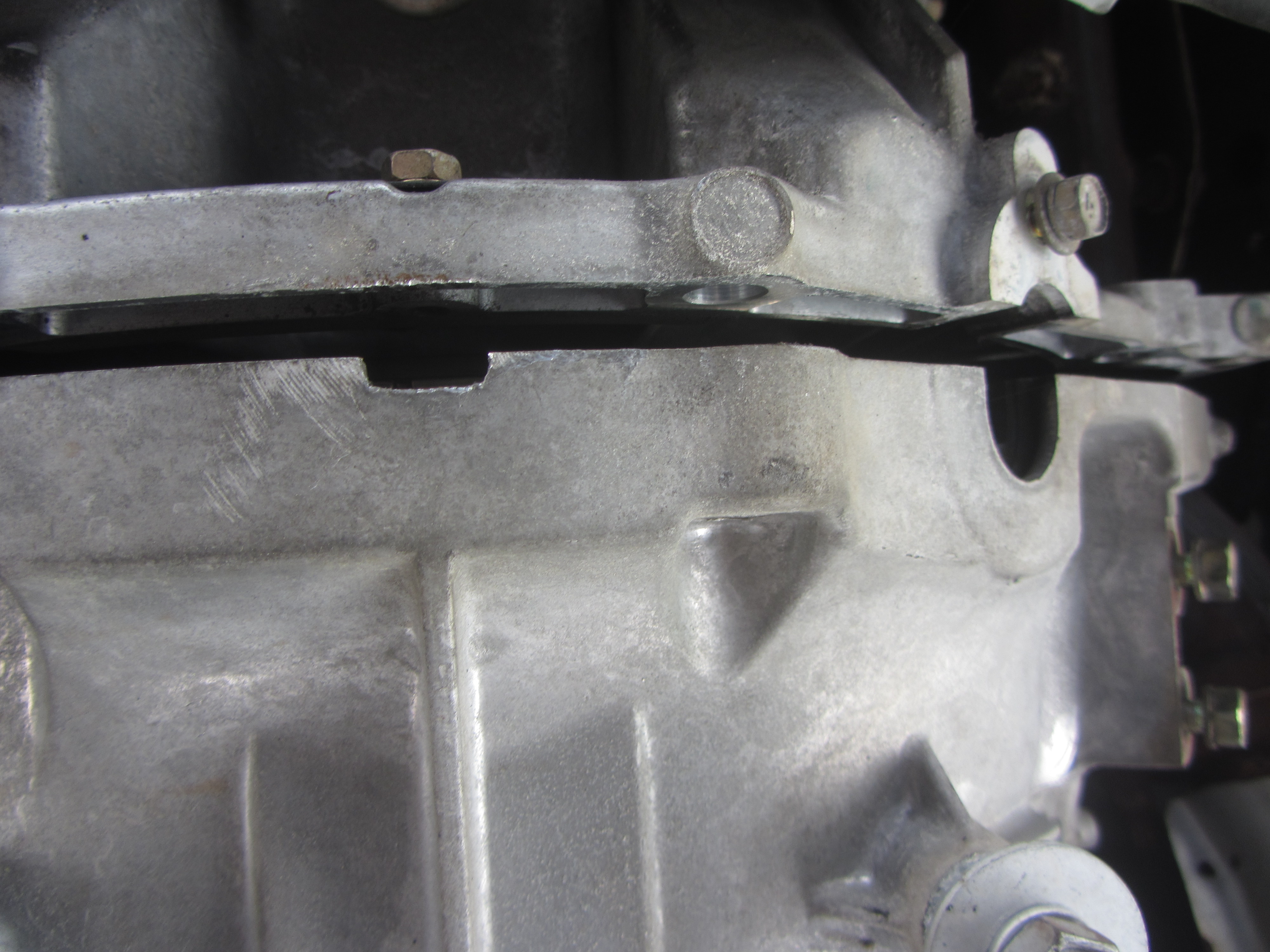

The bell housing has been moved away from the engine about 1/4 inch as seen at the bottom. The space is less at the top but there is a gap. That confirms that all bolts have been removed. Something is inhibiting further motion. Using more force risks breaking that "something." A harness? A bracket? Ideas? Suggestions?
I find no mention of a loom in the Factory Service Manual or any of the YouTube videos. Please elaborate.

In the original post I said all the bell-housing bolts had been removed. I was certain of that... and was wrong! One bolt, in a no-see position, had not been touched. When it was removed the tranny came out without difficulty. Lesson learned!

It turned out that one difficult-to-reach bolt had escaped my notice. It was at position "one o'clock" as viewed from the back of the car. When that bolt was removed the tranny came out easily.
Be patient! Good luck!
