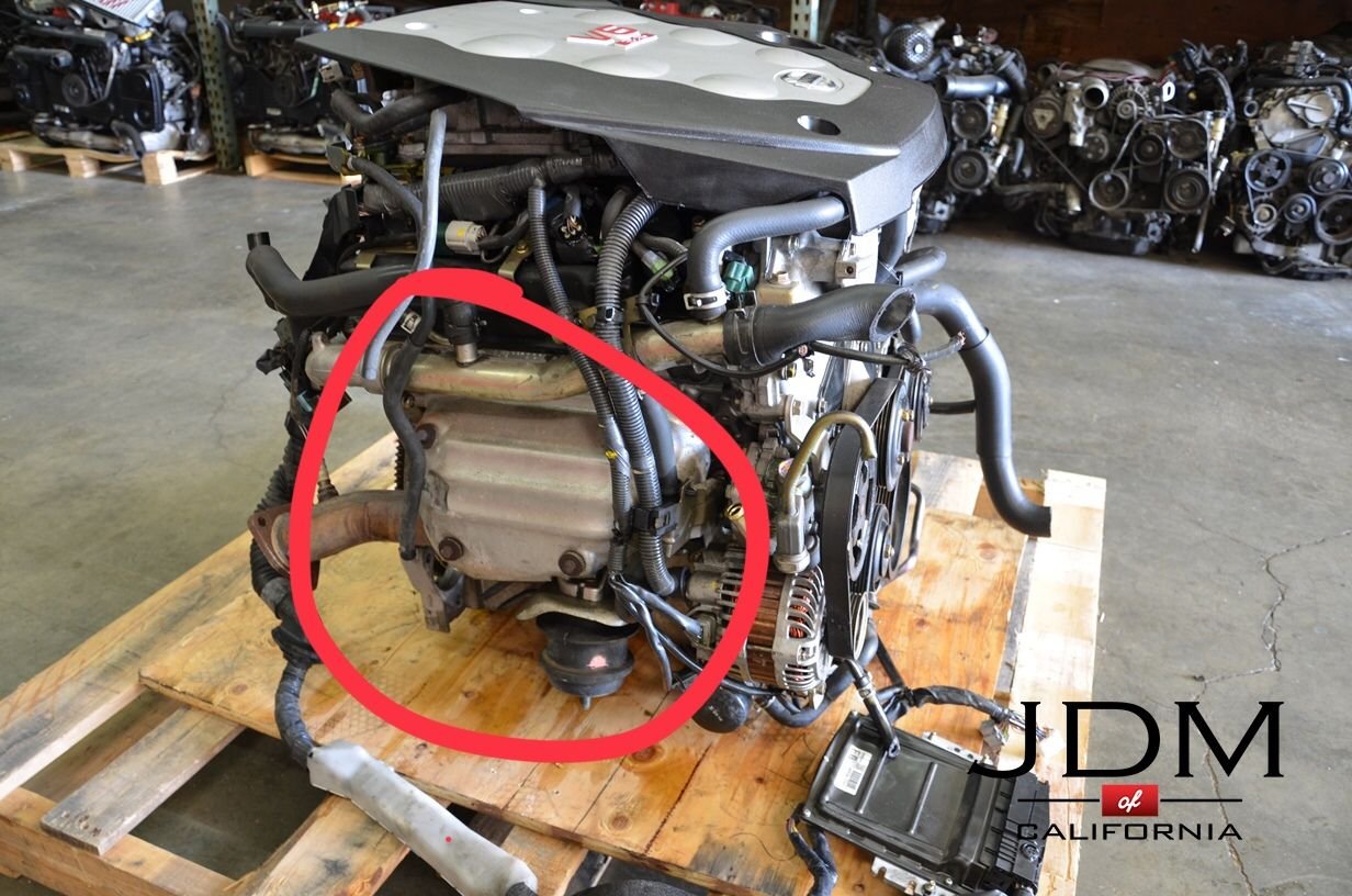

Just recently I’ve been getting a few drops of what seems to be oil when my car is parked in my garage for a few hours.Its nothing much but a few drops a day.Anyways it’s been getting over my steering boot along with some around my oil filter.At first I took it to a mechanic and he said it was my steering rack but I found it kinda fishy.After doing some investigating myself for a few minutes I noticed that I believe that the leak is coming from above the passenger side steering rack.Can somebody PLEASE tell me what that part is called that is circled in red.It is located on top of the passenger side boot/passenger side compression arm.

I believe it’s the metal part where the valve covers go (sorry my engine knowledge is bad) but underneath it.the valve covers were replaced 3 weeks ago and haven’t had any issues since.there isn’t any oil sludge around the valve cover or spark plugs holes

That's just a heat shield over the headers but the valve cover is directly above it. That back passenger cover is REALLY tight when putting the VCs back on, if they didn't unbolt all the EVAP stuff to make more room then there's a really good chance they didn't get the gasket on properly. If you're leaking motor oil that's probably what happened.
Did you have these leaks BEFORE getting the gasket fixed?

No visible leaks just a very oily driver side valve cover but my passenger side was always nice and dry.Now it’s my passenger side that has the problem

Like Cleric said: the passenger valve cover gasket. It's the only place that oil can come from on that side and hit your manifold shield. I would make sure and carb clean everything and let it run for 30 mins re check for leaks. Very hard to find leaks after driving since it gets blown around. But I have learned that oil leaks always go down and towards the rear of the car.

thank you you were right! Took my car to a Nissan dealership and they performed a Dye oil leak test and they confirmed it was my valve covers.Turns out it was both and they had told me that my previous mechanic added too much rtv and didn’t seal them up right.They also told me that there was no way to save them as the gaskets will rip during removing them.It was my fault for buying cheap valve covers from amazon for $30 each.They will be putting in OEM covers and gaskets and it’s going to cost me a fortune but oh well I don’t trust anyone around my area with my car so I’m going to trust the Nissan mechanics with it.Thank you so much cleric you really helped!

This is probably too late but you don't need to have the dealer hose you for all new parts and labor. The valve covers weren't your issue, it was they were improperly installed. The inexpensive VC's from Rockauto work great if they're installed correctly. Live and learn I suppose.
