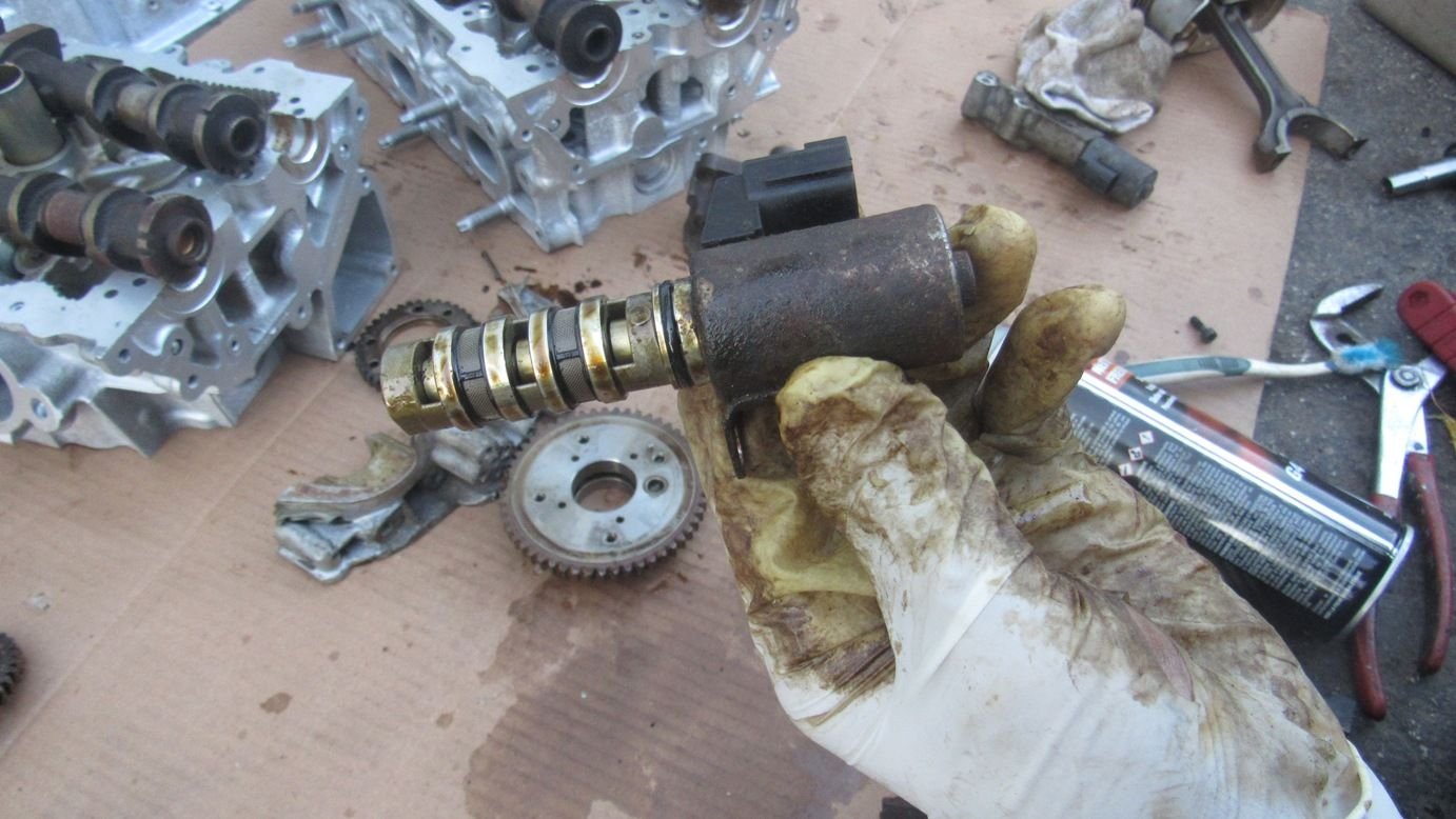

The VVT actuator is the heart of the system, using oil pressure built up inside chambers to rotate the output shaft relative to the input shaft, changing the phase angle:
See the small holes where oil travels into the chambers:
This is the solenoid the controls oil flow through the camshaft to actuate the timing gear in advance or retard:
