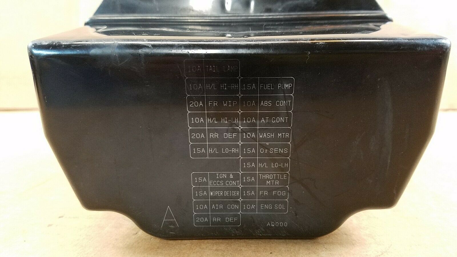

- SOLVED: I found that the “IGN and ECCS CONT” fuse in the IPDM was blown.
2. Once I put in a new 15A fuse, the ECM was getting power and could read the check engine code which was showing P01078: Exhaust valve timing control position sensor. I had replaced the passenger angled position sensor not too long ago but was getting this code with the lazy starter start a few weeks prior.
- UNRESOLVED: Still showing P01078 even after resetting the ECU by disconnecting battery for one day and resetting with Torque scan tool.
3. Also, found that the 10A “ENG SOL” in the IPDM was blown which is routing power to the STARTER RELAY. Once replaced, the car started up again (but with a lazy start).

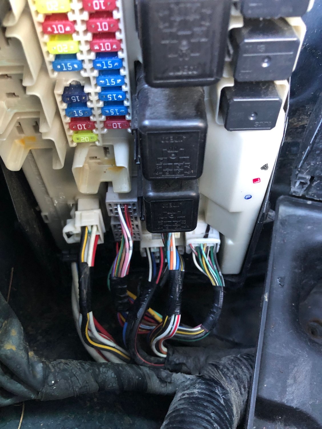

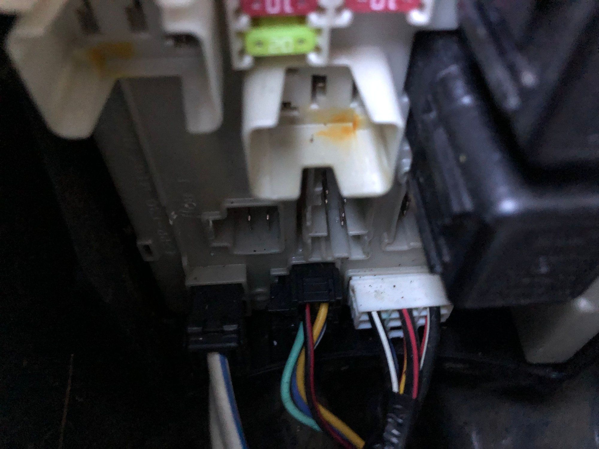

I need some assistance troubleshooting this problem. There may be a short somewhere. I may also think this may be a defective IPDM. The STARTER and IGNITION RELAY area is showing some rust (see pics below). The drain area near the battery was clogged and some moisture was captured under the battery area. We had some rain in the SoCal area the last few weeks.
Sorry for the long post, I wanted to capture as much detail as possible. Any help would be greatly appreciated. Thank you!
Bottom 4th Relay on Left = STARTER RELAY Middle Relay = IGNITION RELAY
IPDM Fuse Decoder

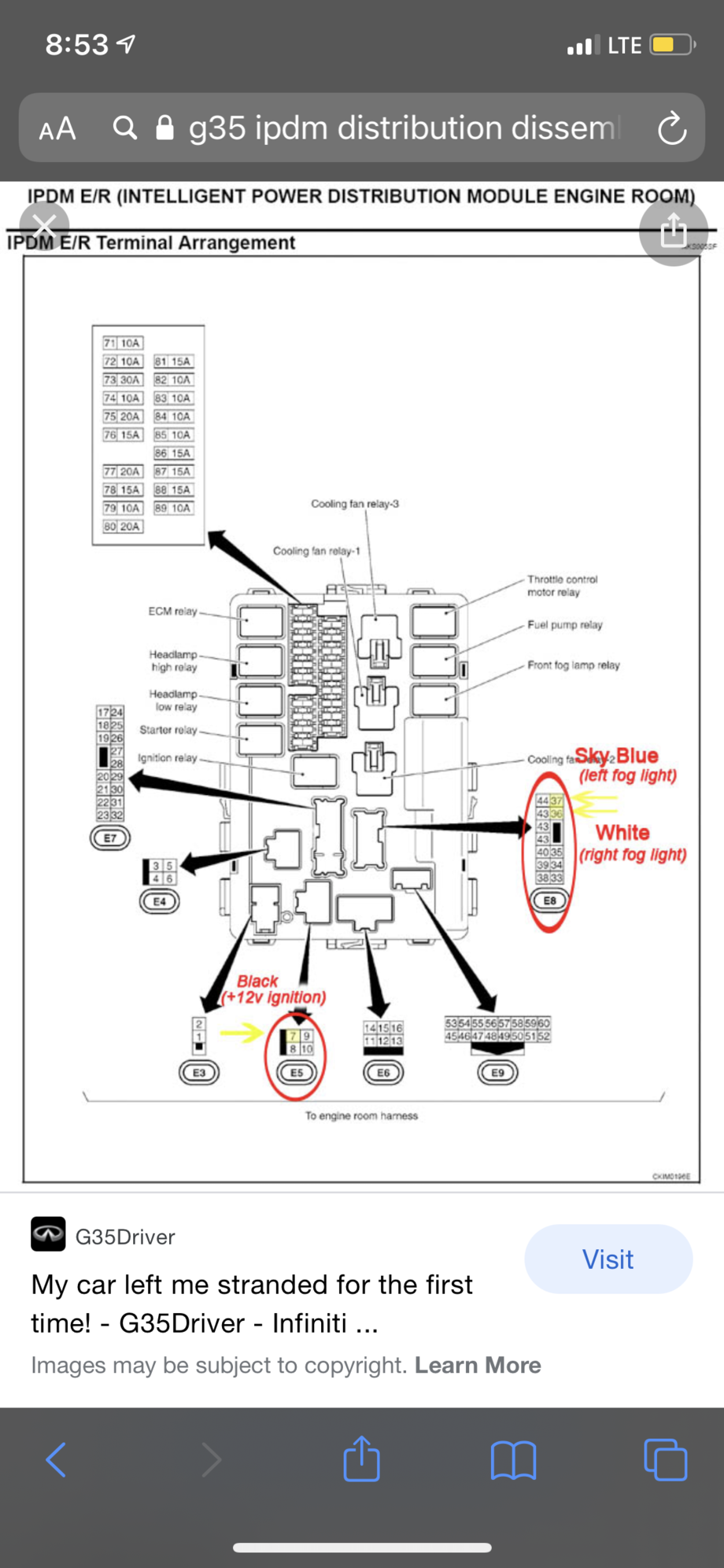

IPDM Relay Decoder

As for the IPDM, I would unplug/remove it, take a good picture of the location of everything, disassemble completely down to the printed circuit board and put EVERYTHING (relays/fuses included) into a bag of rice overnight to dry it out just to verify it's not a moisture issue on the inside.
