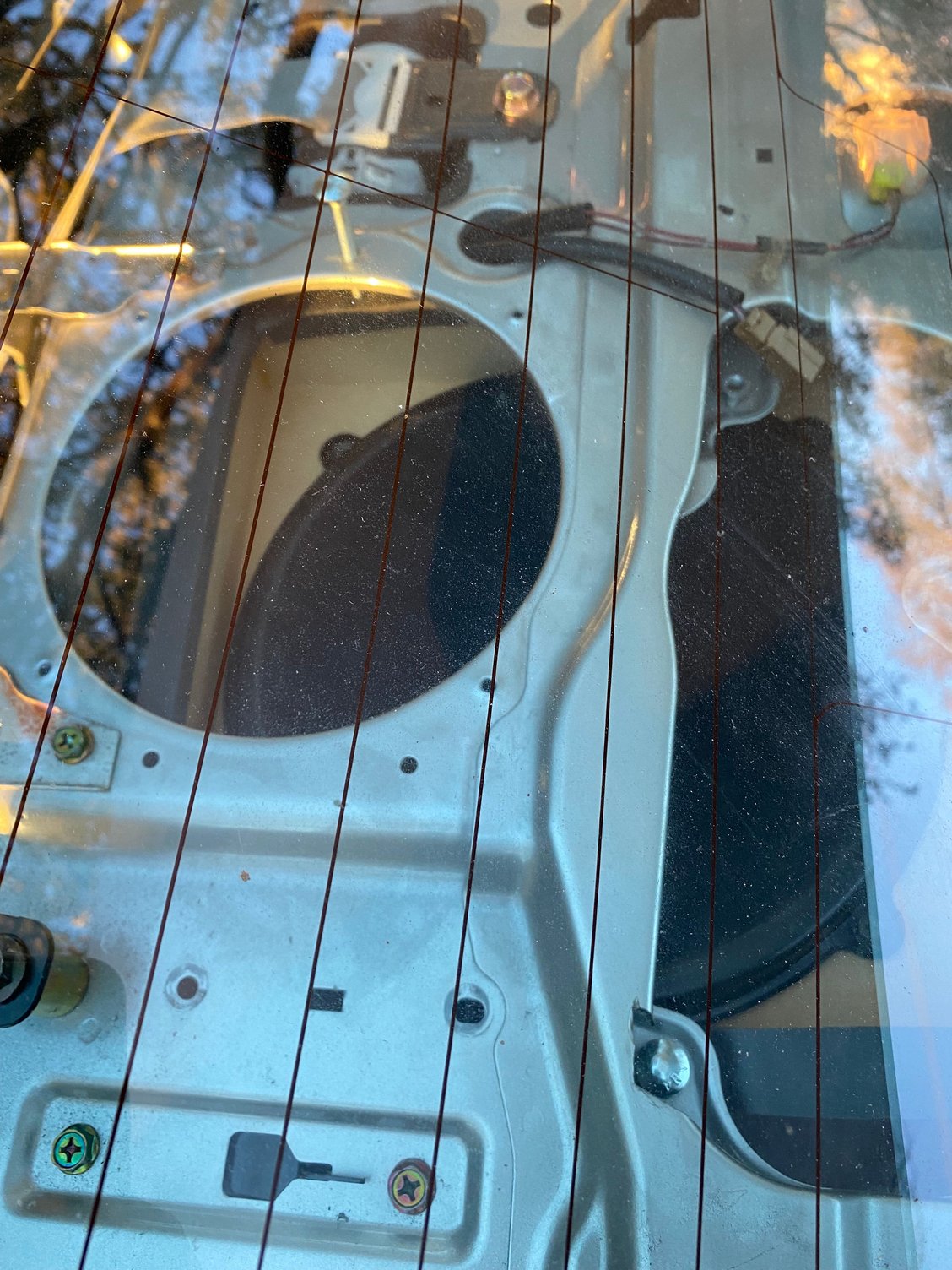

The idea behind a infinite baffle is that the front plane of the speaker cone is isolated from back such that the trunk or baffling behind the speaker acts as the “box”. So if I could rig something that would allow me to mount the 10” speaker on the existing 8” hole while also sealing against the top of the trunk it should give decent sound.

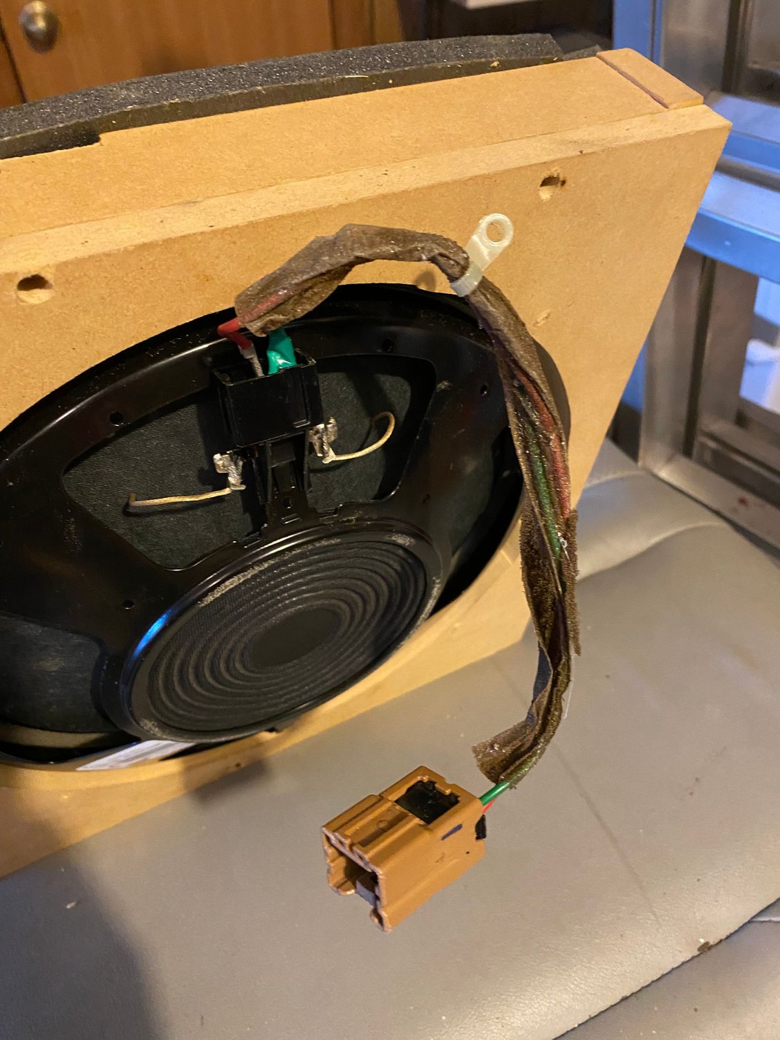

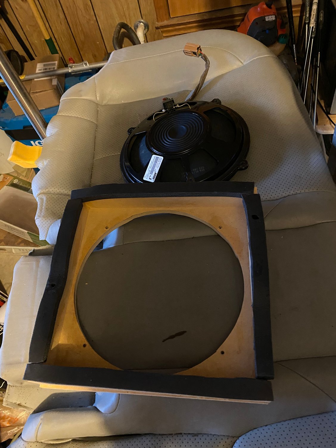

I ending up making a mounting box that looks like this.
As you can see, I just reused the existing connector from the old sub and it plugged right into the Murano sub connector with the existing wire plugs. I then mounted it flush and installed closed cell foam I have lying around so I could get a airtight seal when I pushed it against the top of the trunk.

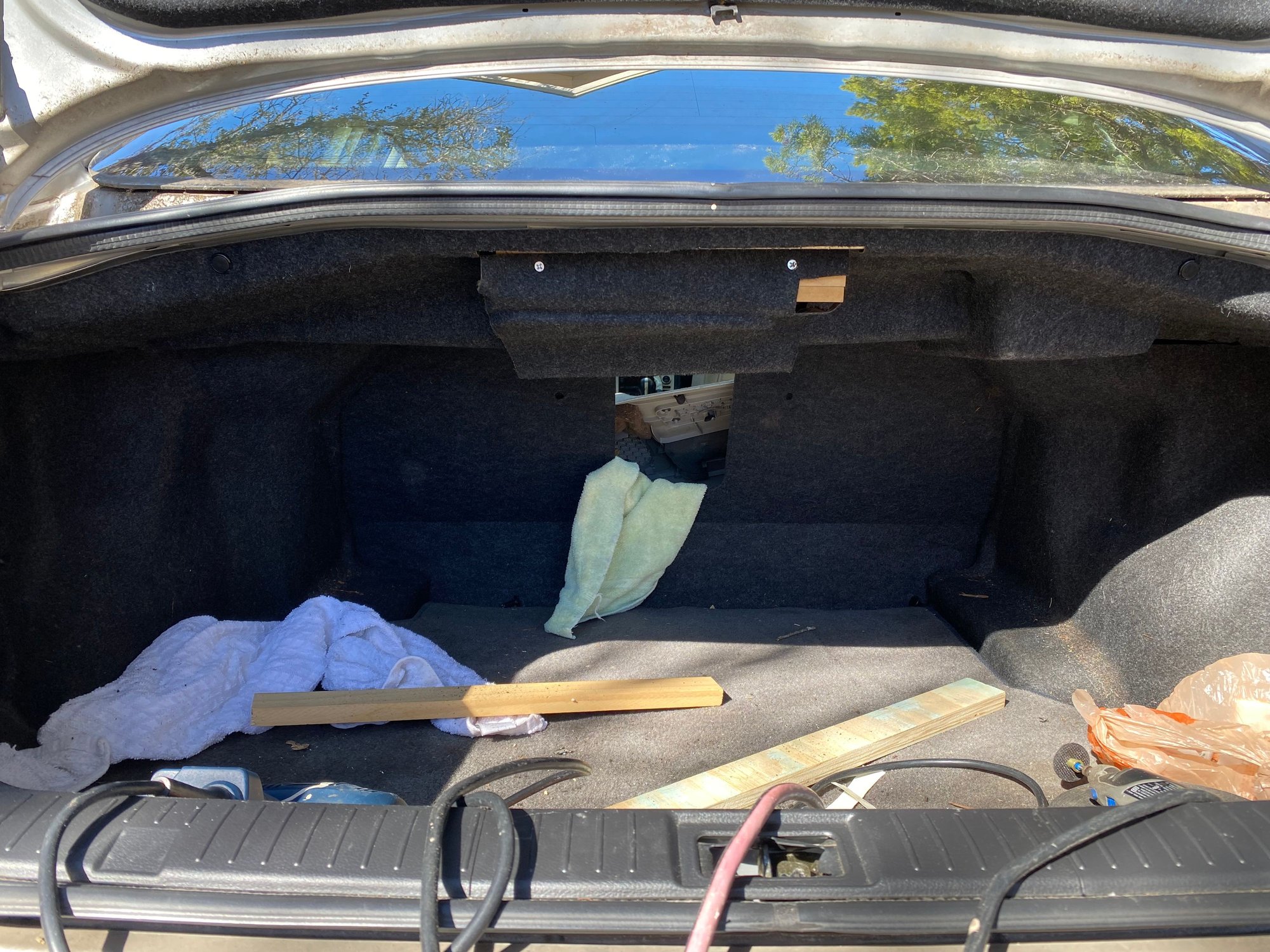

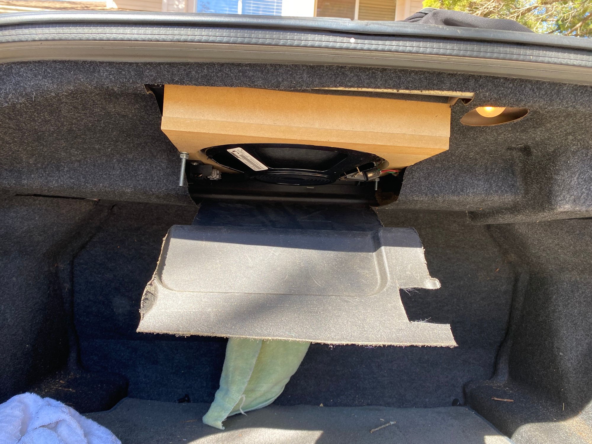

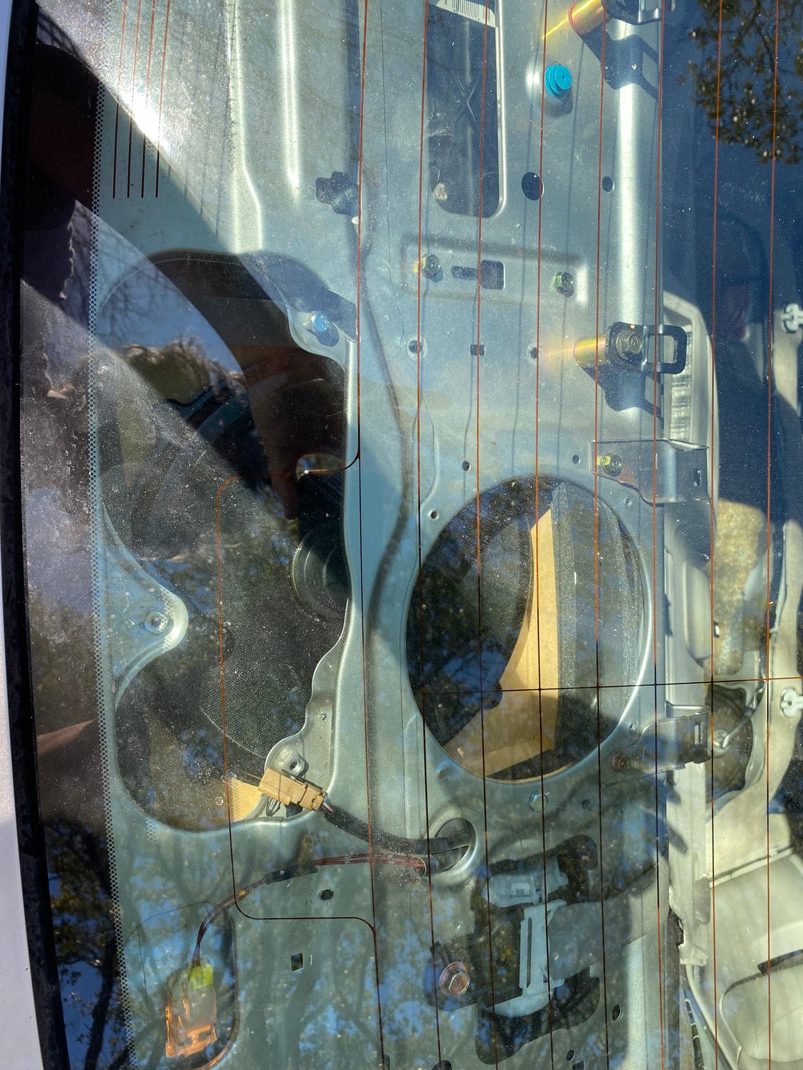

The result is this.
Notice how I put some effort in to seal the air holes up with closed cell foam such that the speaker is isolated form the trunk. I had to move the "keyless entry sensor" to make room for the box and I mounted it to the box. I also mounted the snap connector to the top of the trunk. The whole result is fairly low profile.
I then cut a flap in the existing trim and closed it all up and protect the spider of the speaker from impacts.
