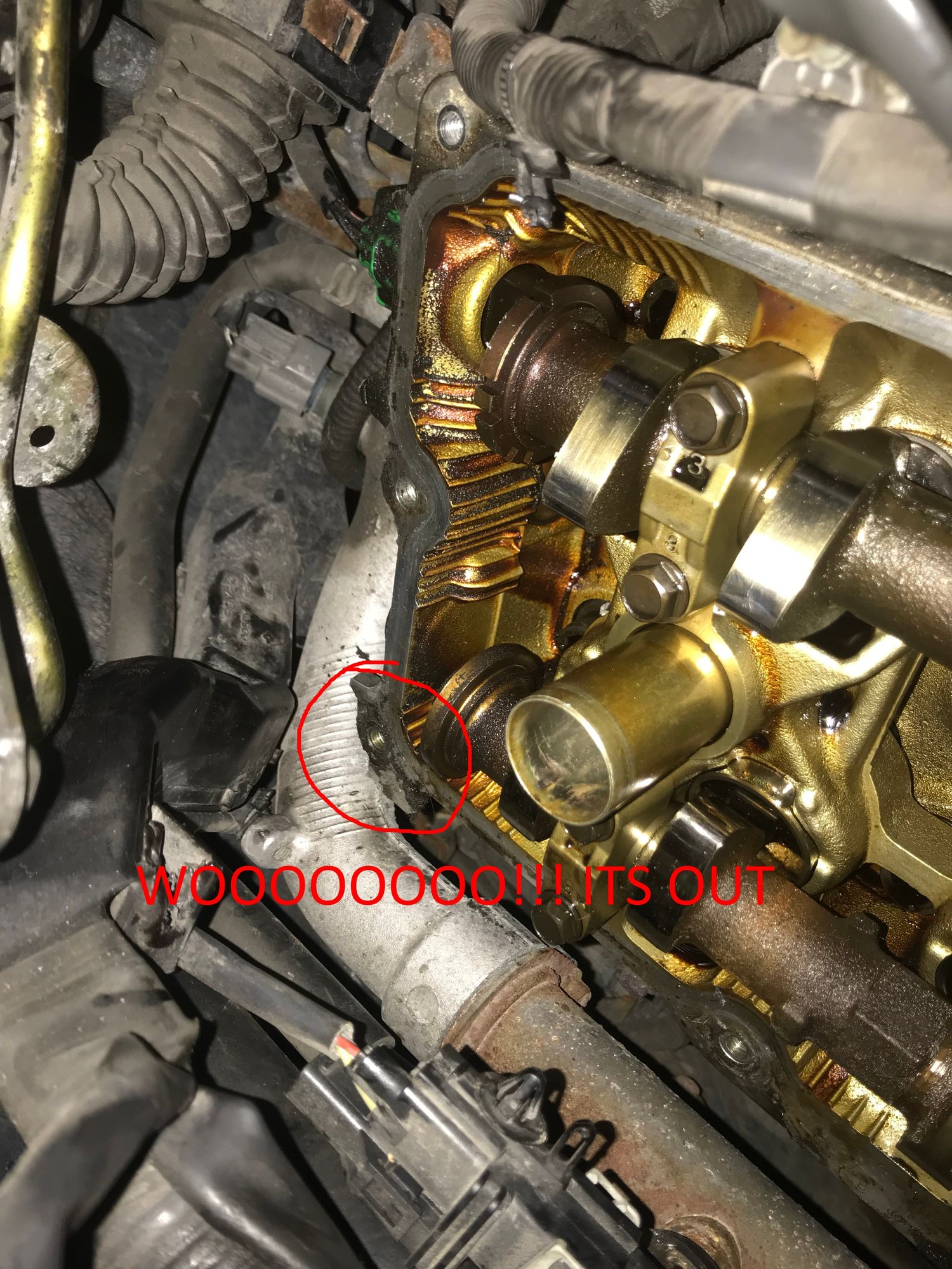

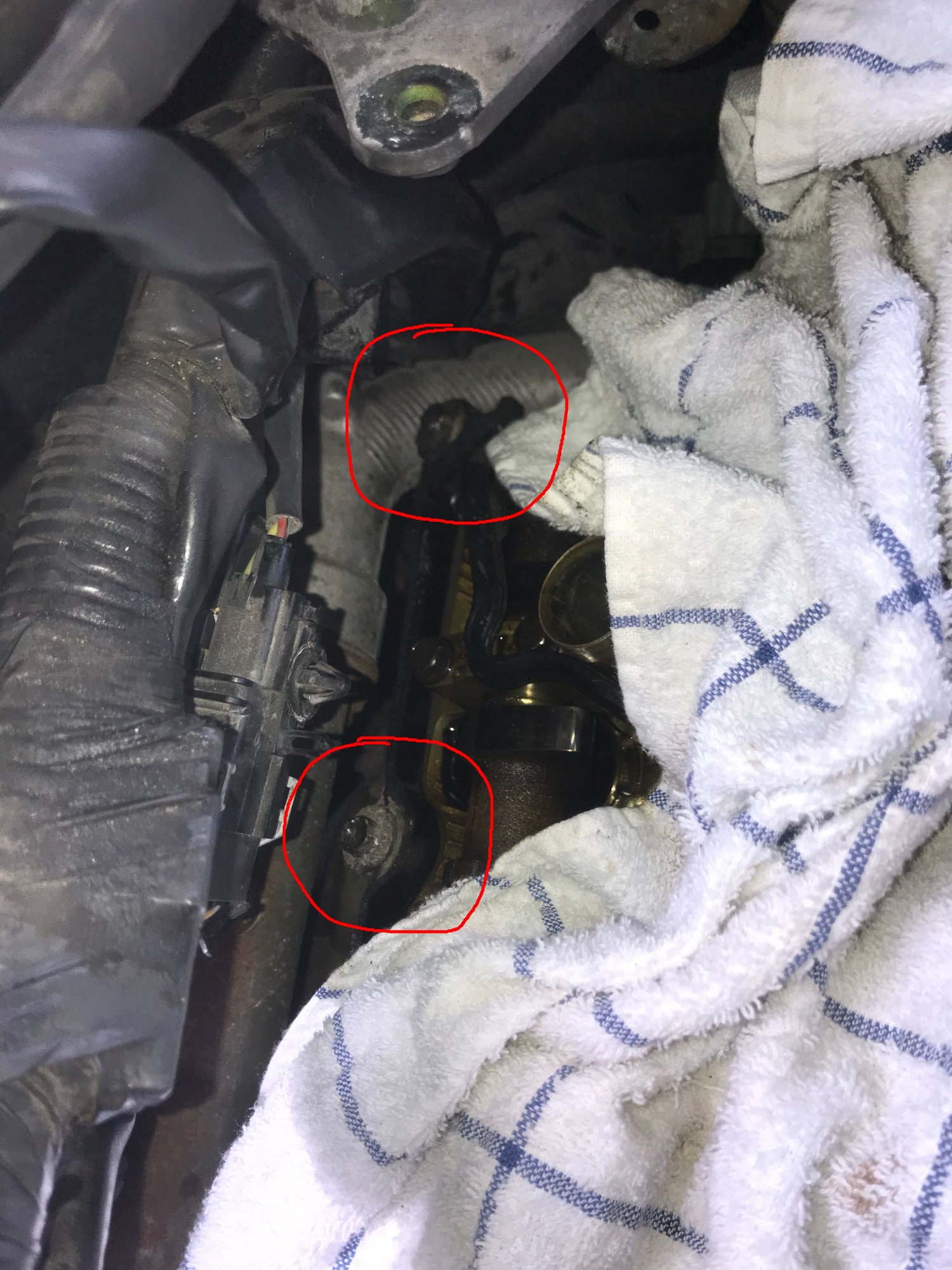

Hey guys,
I'm currently in the middle of replacing the valve cover gaskets on my 2005 G35x sedan and unfortunately, the heads of the two bolts in the corner (which hold the cover, towards the firewall) on the passenger side bank have stripped. The one closest to the front is quite stripped whilst the one in the very corner is slightly stripped but still doable. I ripped off the valve cover to get myself more room as I have a new set to replace them with. I've tried vice grips, taping a 9mm/8mm onto the bolts with a hammer but to no luck. I'm about ready to drill the bolts out but due to their location and angle, I don't know if it's even possible. Keep in the mind the bolts are quite soft due to age and heat (I think?). I'm no mechanic so I really don't know what to do. The main problem is the location of the bolts as there is hardly any room. Any ideas/suggestions?

What usually gets those bolts is when RTV sealant is used for the valve cover gasket and then gets down on the threads of the bolt.
Are you using 6 point sockets or 12 point? If it's 12 point then throw them all away and ONLY use a 6 point socket on a 6 point bolt. That's far and away the number 1 reason for stripped bolts.
If you ever plan on working on an Audi then keep the 12 point sockets in a special box for those incredibly few times you have 12 point bolts.
Honestly I don't even know why socket kits have 12 point sockets, I've only ever seen them a handful of times in my life and it was always on an Audi...
Now, for the issue of removing those bolts, get a smaller pair of channel locks, not vice grips, just like a 13" long pair of channel locks, those bolts will come out.

You're spot on, I started with a 12-point (not realizing it) then as it started to strip, I switched to a 6-point but it was too late. I did the other side first and it all came off no problem with the 12-point so I just didn't notice until I got to the troubled bolts. Going to the store first thing in the AM, I will give an update tomorrow. Thanks a lot!

Update: Turns out I had a pair of channel locks hiding in my garage that I have no recollection of buying (lol). Weren't quite as small as I would have liked but it did the trick. I really appreciate the help! @cleric670

Vice grips could work, you just have more control with a pair of channel locks and a good pair (I prefer Knipex) will easily get a strong bite on the metal. If it was a bigger bolt that was going to need quite a bit of pressure applied then yes vice grips would be the correct tool. However these are tiny little M6 bolts, thus the channel locks. They also fit into tight spaces better than vice grips.

The main thing that I noticed is that the channel locks I found were much longer than the vice grips I own, which gave me better leverage (super helpful in a tight space). Having to squeeze was a little annoying (I'm really weak) but I was actually able to turn and not hit a cam lobe or coolant line like with the vice grips.
