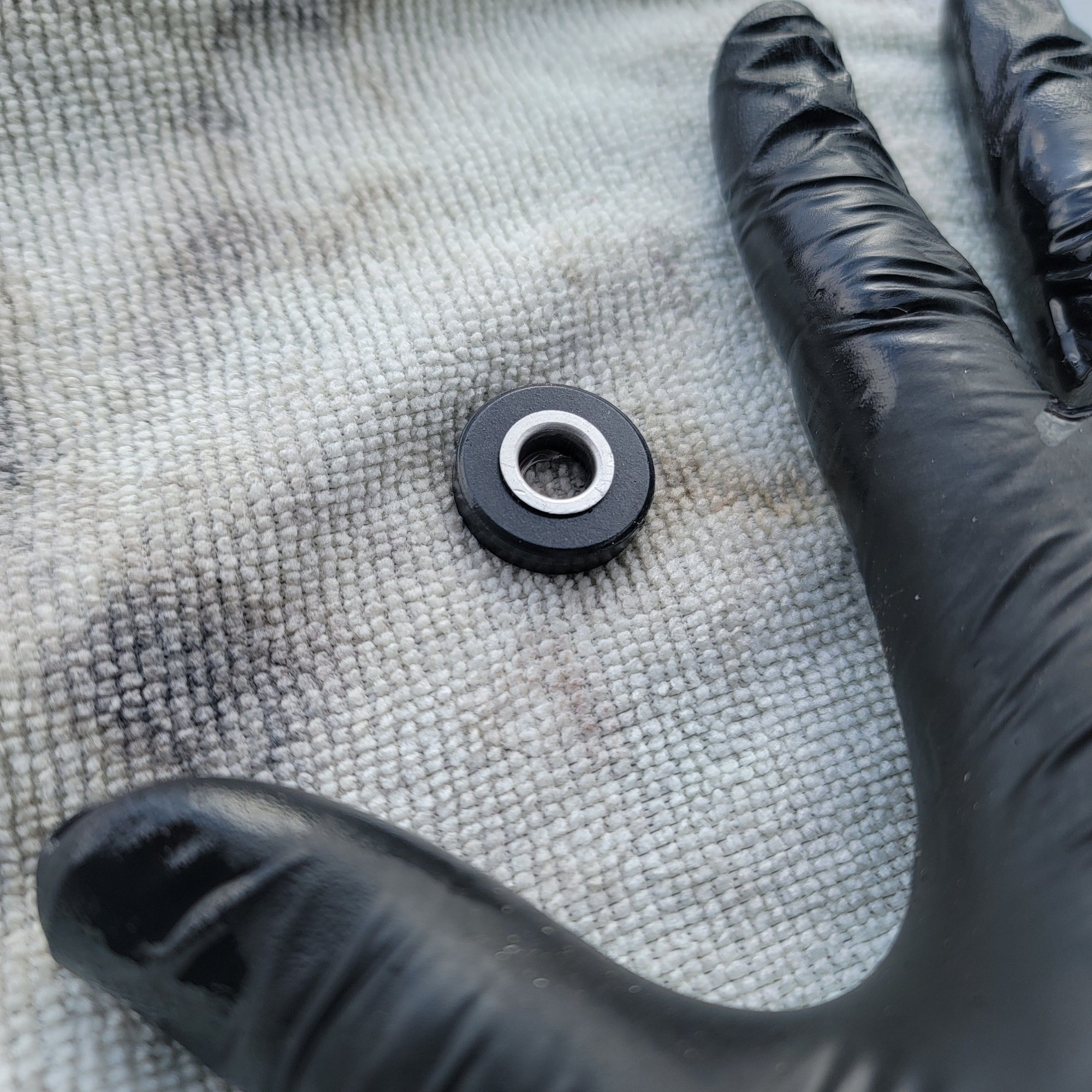

I drained the transfer case and this came out
To identify, you can download the FSM from nicoclub and look at the exploded diagram for the transfer case. Attached is the diagram from my 2006 sedanX (RIP) FSM.
Quote:
thanks I found out its just part of the drain bolt. I don't know how it got torn up like that though.Originally Posted by G2B35AGN
