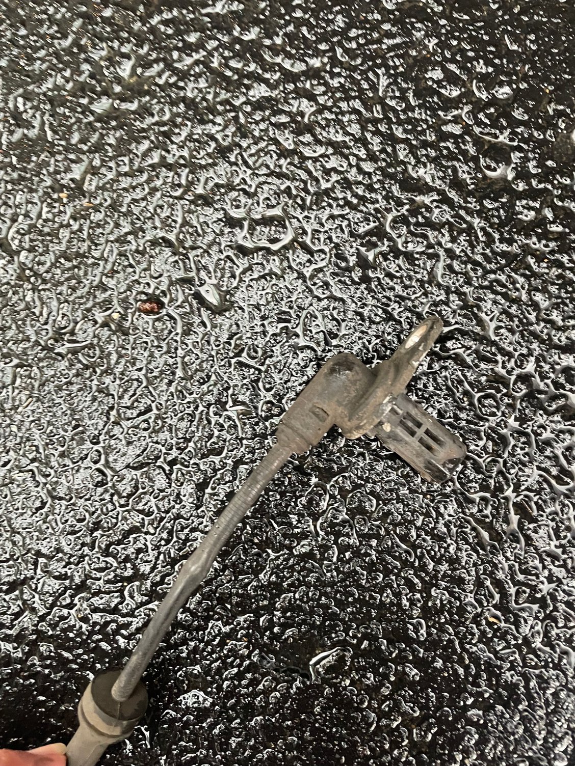

Hi everyone. The strangest thing happened to me. Bought this part from Rockauto. According to rockauto, Holstien and everywhere else it should be the correct one for my car. Yet, when I compared it to the current sensor, it has a different sensor head and has 4 rubber grommets versus the 3 on the Holstein part. Anyone encountered this issue? Don't know what part to order. Attached is the current sensor head.
Sensor head

What year is your sedan?
Does the harness plug into your car?
its a 2006 manufactured in late 2005. I have uploaded a picture of the plug end of the sensor cable. It connects to another plug behind the wheel well trim.

That's weird, must be something different with the AWD cars, my 2006 coupe has three grommets.

I was able to find the correct part here. For some reason it’s the one that is supposed to be for the front right that matched my front left.
