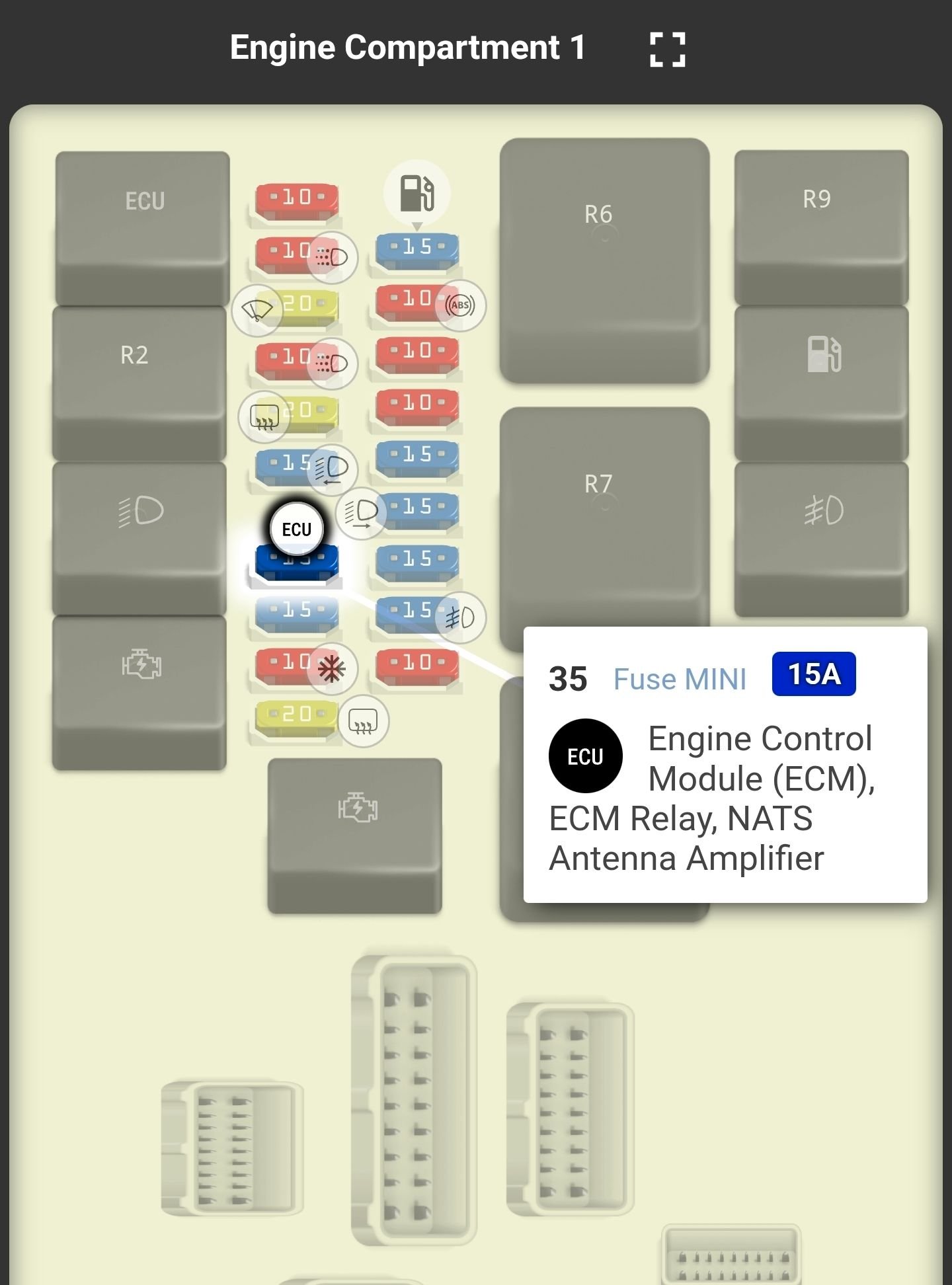

[QUOTE=cleric670;7219757] Yes, there should be current at terminals 119 and 120; these come from the ECM relay when the key is in the ignition position. First, check IPDM fuse 77, which sends current to the ECM relay. In fact, check the fuse slot to check that there are 12 VCCs permanently. If there is no 12 VCC, check the E slot of the fuse link, which sends current to the IPDM fuse 77 along with other components. If fuse 77 has current, check that there is also current in the ECM relay, remove it and check the IPDM pins. There should be 12 VCCs on one of the pins on the relay, which will disappear when fuse 77 is removed.]I have a problem: the fuse is cracking on the ECU on the IPDM, look, you know a lot about it, I wanted to see if you could help me with my problem.
Hello, I have a problem, this fuse is breaking, someone could help me with that problem.
