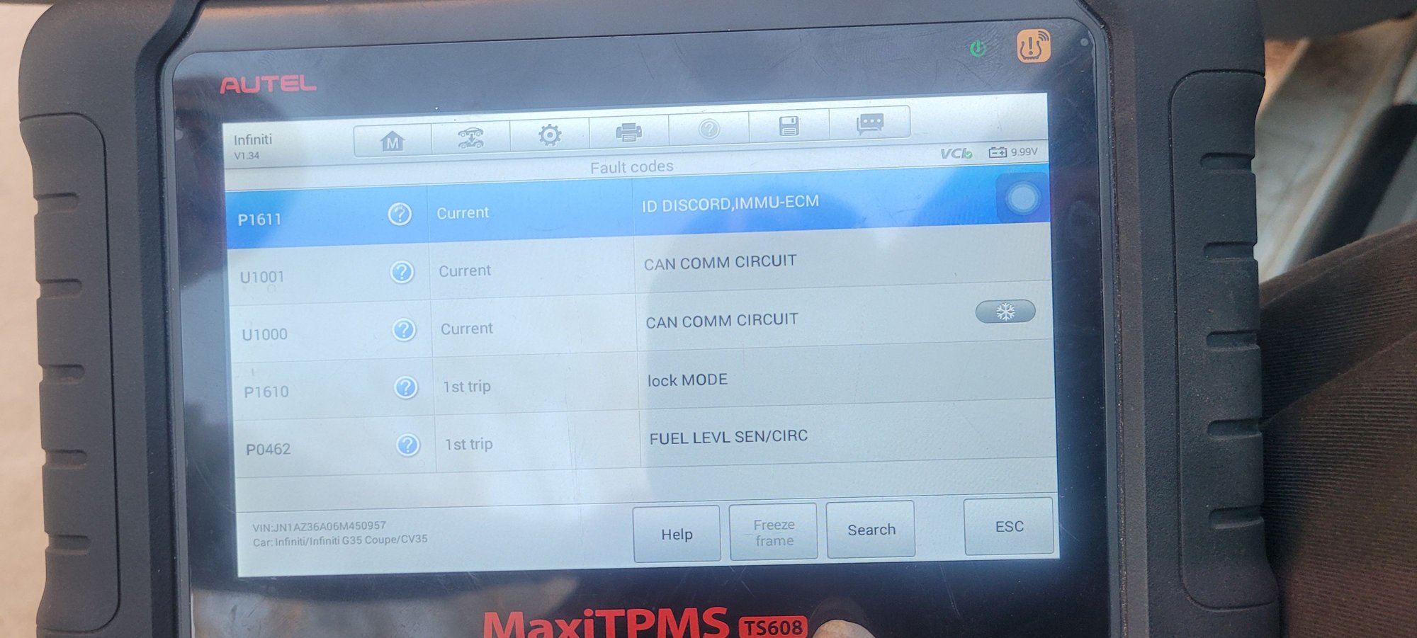

so I got an update on this turns out I did get 2 bad ecms the third time was ghe charm got 5 codes and atill a no crank no start

Code P1610 Nissan Tech Notes
This code is usually triggered when a not registered or damaged key is used to start the engine. When the starting operation is carried out five or more times consecutively with the same unregistered key, the system will lock. If the problem occurs try disconnecting the car battery for about 30 minutes and then try starting the engine with a known registered key. If the problem persists you have to have the dealer erase the code and reprogram the keys again.
If problem persists after disconnecting the car battery, try the following:
ESCAPE FROM LOCK MODE
1. Turn ignition switch OFF.
2. Turn ignition switch ON with registered key. (Do not start engine.) Wait 5 seconds.
3. Return the key to OFF position.
4. Repeat steps 2 and 3 twice (total of three cycles).
5. Start the engine.
Old Jan 26, 2023 | 05:20 PM

The real question is with all of the ECM and BCM swapping did you pair the key?

haha I did not man believe it or not I thought I had f up my ipdm during the swap I was really thinking also that I've might have forgotten something to but I'll try programming a key tomarrow and I'll keep you guys updated

If you replaced JUST the ECM then it probably still won't work. The ECM and BCM are programmed together, you can either have Nissan Infiniti program them back together with the dealership Consult - II / III tool or you can do it yourself with Nissan Datascan, a laptop, and an interface cable. You can use an online BCM decoder if you want to do it yourself with NDS2.
The key RFID chip is then programmed to the BCM.
