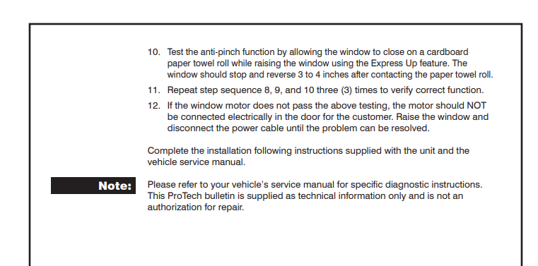

••• Does this even apply to our vehicles?
A PIA if I have to pull the new motor out again to simulate this and run the motor not attached
https://youtu.be/d6UvdbJ3nFk
https://my.cardone.com/techdocs/pt%2047-0001.pdf
