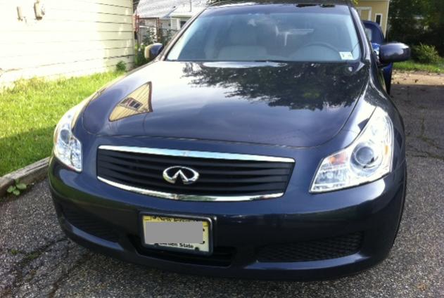

I just Plasti-dipped my grille, and the sun started going down as I was wrapping up. I'm assuming it came out good, but I'll wait till tomorrow morning, when I realize that one of my headlights is black, haha. One thing I noticed though, is a fair amount of overspray on top of the hood and the front license plate bracket. I hear (hoping) that alcohol and a piece of cloth will make removing the overspray a breeze? Any ideas? I'll post pics tomorrow.
Old Sep 26, 2011 | 01:23 PM
mroadster2k's Avatar
Posts: 103
From: Middlesex, NJ
Process was very straightforward. I think it came out pretty good. Next, heading to the body shop to get my Stillen lip paint estimate..
