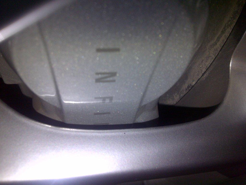

If you are talking about the Infiniti Akebono BBK, 17" stock wheels will not fit over them. My stock 18" sport wheels only clear them by about 1/4" on the o/s and 1/2" on the inside of wheel. 17's would be rubbing the calipers.
For daily driving, I don't feel any difference in the BBK I have now compared to the stock brakes I had on my 07x. Like someone mentioned, it's when you track it that it will make a difference. ...and they look a lot nicer.
