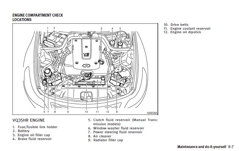

OP - see attached for brake fluid reservoir - it's some what hidden just like the battery but on the opposite side of the engine bay.

your break fluid is located under the driverside cover near the firewall...it is about 4 inches long 2 inches tall and 2 inches long.

thanks guys! my brakes fluid is full... guess i'll have to let the stealership handle this
