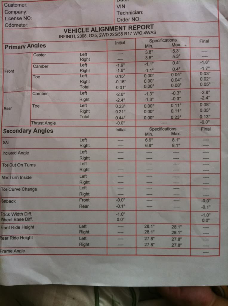

Thanks Mike... Always helpful.. I got the toes within specs on my last alignment.. But with some rear camber.. What do you think? Still need the toe bolts?

If you plan on bringing camber back to spec, that toe will increase. When you give on one, you take from the other, and vice versa.
Otherwise, those are actually pretty good specs. The toe is a little high, IMHO, but nothing too bad.
