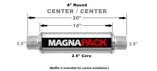

alright guys...so i have made up my mind
This is what i am going to do... I am pretty much going to get the Magnaflow catback exhaust made for my car for a third of the price... I called magnaflow and asked them for part numbers of the resonators and mufflers used in their cat back exhaust system for the 08 sedans...
They gave me the part numbers: 14226 (muffler) and 14416 (resonator) I will need 2 of each.[ATTACH]
[/ATTACH]
These are the exact parts used in full catback exhaust system that sells for 1300.00.... I am going to order these from performance peddler, which comes to a total of 300 + tax... then I am going to attach them together at a muffler shop with 2.5 inch piping and possibly the magnaflow xpipe # 11385 which is like 90 bucks at performance peddler as well. So, instead of wasting 1400, I can have the same thing for about 500 to 550....
what you guys think ???
[/ATTACH]These are the exact parts used in full catback exhaust system that sells for 1300.00.... I am going to order these from performance peddler, which comes to a total of 300 + tax... then I am going to attach them together at a muffler shop with 2.5 inch piping and possibly the magnaflow xpipe # 11385 which is like 90 bucks at performance peddler as well. So, instead of wasting 1400, I can have the same thing for about 500 to 550....

waassup guys, just wanted to update you and let you know that i ended getting all the parts from magnaflow and had it installed with 2.5 inch piping...it all fit perfectly.... just as if i were to buy the whole catback exhaust from magnaflow...sound clip coming soon..

@ HighhRevvG, I think you'll like the new sound it makes. There are a few folks here who have done the same thing you have with sound clips and it does make a difference. I originally went straight piping (2.5) all the way back to the mufflers (Magnaflows) but the sound was way too loud. I am also running HFCs. My current setup is still along those lines but added resonators back in to tone it down. She hums very nice now with no drone. May be changing it back up when I get back stateside and try an X pipe with the HFCs.
