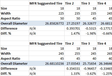

Here's he change with the overall diameter of the tires with different sizes.
I suppose if you give it more meat / weight on the tires, there will be a slight set back in performance. And it will raise the CG a little as well?
But the added traction in the front with wider tires would be appreciated. I always felt the car can use a little more tires. i.e. the car understeer quite a bit when hard on the brakes on a down slope.
I thought 235/50/18 and 255/45/18 are weird sizes. maybe not ...

This is awesome. It reassures my decision with the sizing. Thanks a bunch
