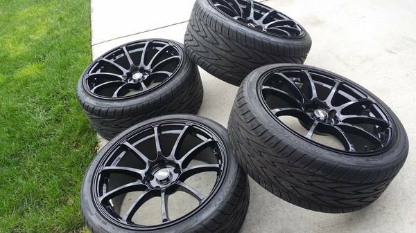

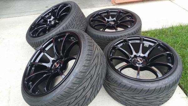

Originally Posted by PLENUMCOUPE
265 might fit with a terrible stretch. You want to do a 285 or 295 with 10.5. Trust me
Look at pictures in the ad. They dint look too stretched. I probably should've included it in the beginning.
Attached Thumbnails Will 10.5 +35 with 265/35/19 fit and look right in the back?-01212_1gxjcrrwbnw_600x450.jpg   Will 10.5 +35 with 265/35/19 fit and look right in the back?-00w0w_b0lwigijjtd_600x450.jpg   Will 10.5 +35 with 265/35/19 fit and look right in the back?-00o0o_froh3py1uip_600x450.jpg   Will 10.5 +35 with 265/35/19 fit and look right in the back?-00l0l_ixzxjzle2hb_600x450.jpg

Old Aug 27, 2014 | 11:09 AM
PLENUMCOUPE's Avatar
Joined: Apr 2013
Posts: 1,401
Likes: 74
From: Southern California
Notice the fronts have a square setup and the rears are stretched. Doesn't even match. Up to u tho
Old Aug 27, 2014 | 11:12 AM
rollaspeed1's Avatar
Joined: Jan 2012
Posts: 140
That one your right. .... crap

Old Aug 27, 2014 | 04:44 PM
Joined: Jan 2012
Posts: 140
I have to say its not too bad, What do you think?
Old Aug 27, 2014 | 06:48 PM
Joined: Apr 2013
Posts: 1,401
Likes: 74
We'll from experience I just got a 8.5 front with a 245 and a 10.5 rear with a 285 and the front is square but the rear is a tiny bit stretched and doesn't match the front which, being OCD about that stuff, drives me cray
