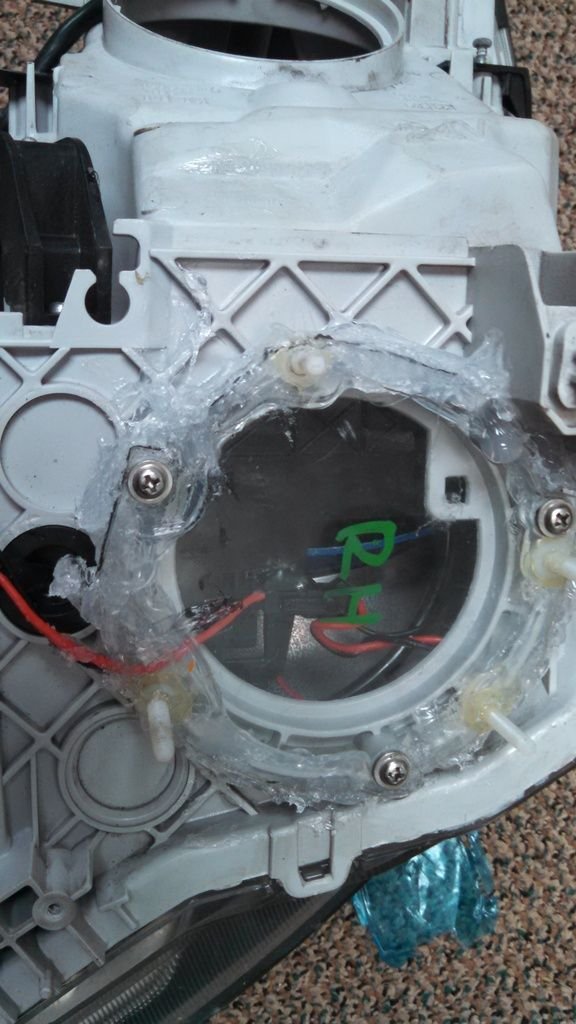

From: MidWest
You can see the three screws that held the ballasts in. I used a piece of trimmed polycarbonate again for this part. I wanted to mount the new ballasts in the same location.
I arranged the ballast in the fashion I wanted to clear the screws as well. Then I got nylon screws and hot glued them to the carbonate.

Clear silicone around the existing gap. It doesn't look clean but no one could ever see this when installed. I also allowed for the halos wiring through the silicone.
