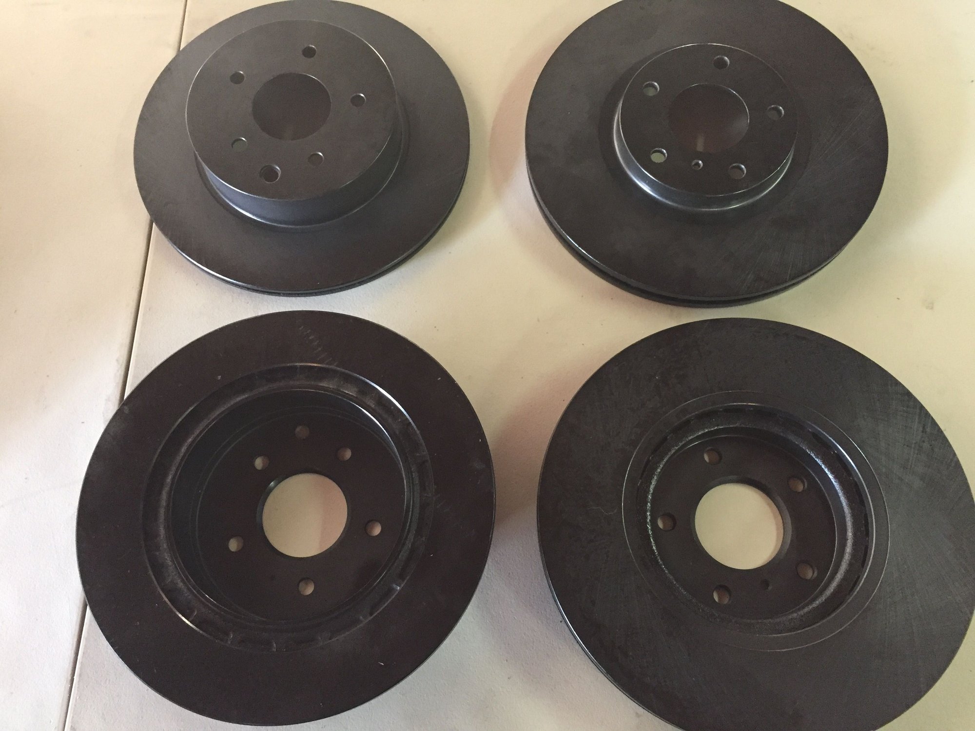

Hey I see your looking to upgrade your brakes. I have a brand new set of centric black zinc coated rotors from CZP performance for sale. They work great with oem pads. I have that setup on my g as of now. Let me know if your interested. They're for 03-07 g35 and 350 non brembo
[IMG] 1st gen brake rotor pics [/IMG]
