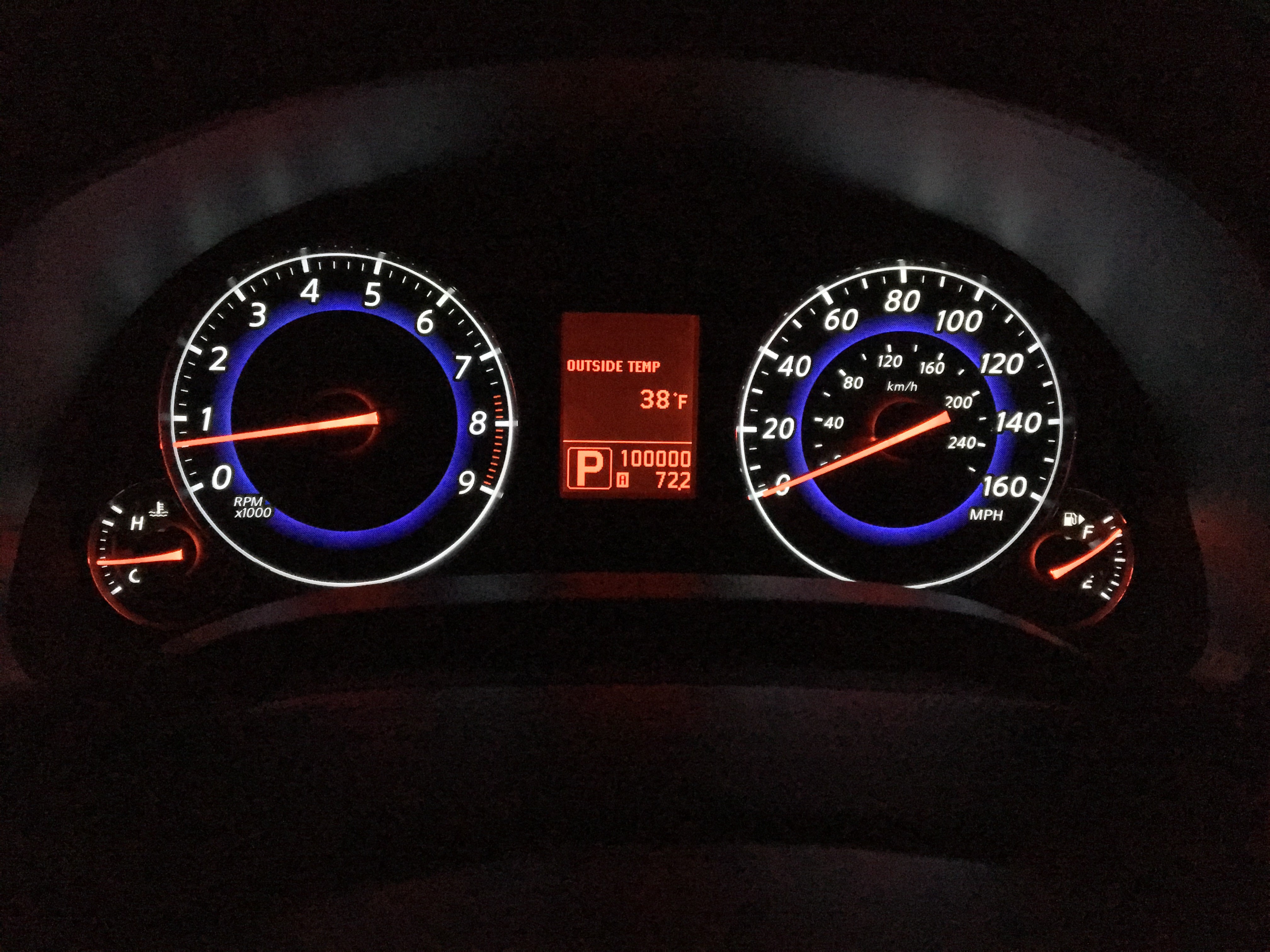

So my 08 G35xS just turned 100k last Friday. Coincidentally (since I missed the actual odometer roll over ) I took this pic that same day, which is one of my favorites so far:

Hit the 100,000 mark myself early this year. Next step, 123,456!
Attached Thumbnails 08 G35xS just turned 100k! Celebration plans...-100k.jpg
Good stuff, man. I was mad that I missed the 100k rollover, might have to use your pic and just say it was a cold day in June
