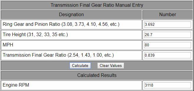

Ok, here's the math on where you should be at for cruising rpm.
thanks for that. I was trying to find all the numbers to do the calculations and got sidetracked and forgot about it.

I read this thread a couple of days ago and tried to make note of different RPMs at different speeds. The only one I remember was 80mph and around 3250 rpm (using the tachometer so that value is 'fuzzy', sorry). According to that calculator above, it shows 3118 rpm so I call it "close enough". I'm going to double-check the input values to make sure they match my car now....
