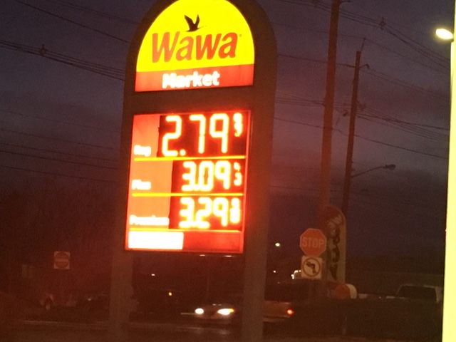

Originally Posted by Hall Stevenson
87-88 octane gasoline with up to 15% ethanol is completely normal in the midwest US and could be elsewhere as well. Probably 75% or higher of drivers use that in their cars. In cars, you don't hear about issues related to ethanol. It can be a pain in small engines - lawnmowers, weed trimmers, etc if you don't keep it fresh.
In the VQ36HR, Nissan recommends 91 octane but do not require it. It is perfectly fine for your G35 too. That 'note' is very odd. Is that on the pump ? What station is this ? Around here, there are very, very few places that you can get ethanol-free fuel. I think even the mid-grade and premium grades include ethanol. If you want ethanol-free, stations near lakes usually have it for boats but it costs a LOT more, like $1 or more per gallon.
How much is regular gasoline and how much is this 91 octane ?
On my third Infiniti
06 G35 6 speed purchased new, traded in at 171796 miles
2012 G37S 6 speed purchased new traded in 94444 miles
Present 2016 Q70 6600 miles
Never used premium on any of my vehicles
Regular 87 octane all the time
