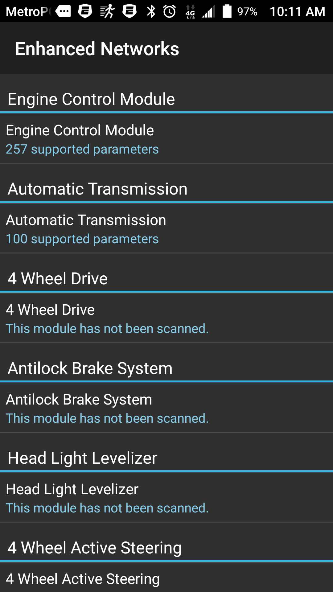

Steps I used to get transmission temp
1add display ( give choice of radial or digital select one)
2 hold on gauge till menu pops up, then select "display configuration".
3 hit down arrow that's after "vehicle speed" to change the input
4 select "Nissan Infiniti"
5 select "automatic transmission"
6 scroll down and select "ATF temperature 1(c,f)"
7 select "done"
8 select "ok'
The pics cover steps 3,4, and 5 I added more but they ended up looking confusing because they got out of order so I removed them. Man I hope this works for you. I searched for a long time and found nothing about how to read the temp. I sent a email with vehicle specifics to odb fusion and they respond that I could access it with there app and the 10$ add-on. Previously I checked my transmission fluid with a laser thermometer at (149°). When I checked the temperature with the app (149°) I was actually a little under a quarter of a quart low. I can tell a difference in the shifts and we know that butt dino doesn't lie.

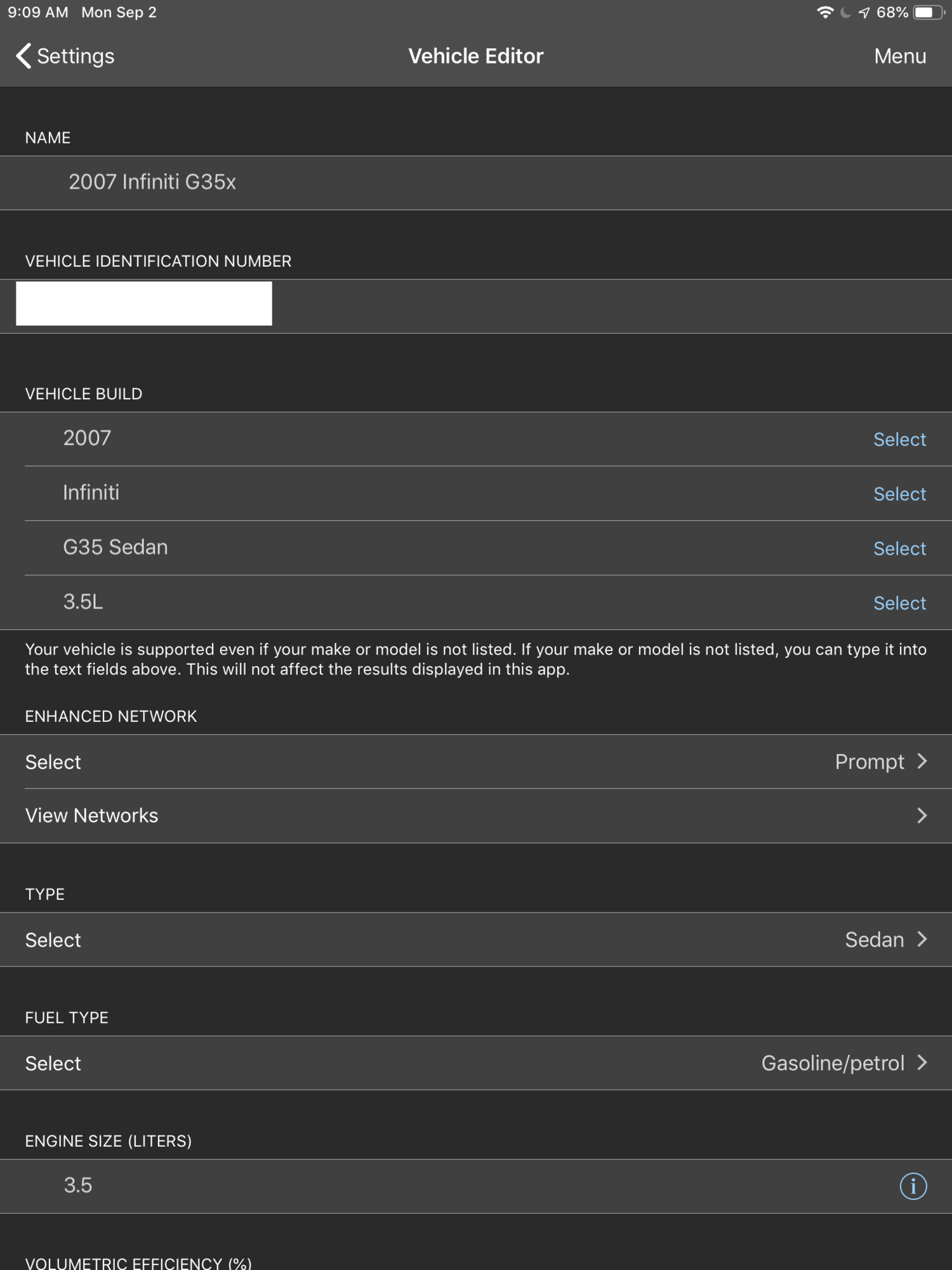

Unfortunately still a no-go with OBD Fusion/Link. I even checked both with an Android as well to see if it was a platform issue. I'm gonna pick up one the adapters you purchased and also reach out to developer.
I'm curious what you see connected to vehicle with Fusion:
Settings -> Vehicle Editor -> View Networks -> Automatic Transmission
How many support parameters does it say it can see?
You should be able to pull this up while not connected as well.
Thanks!

Engine and transmission parameters
100 transmission parameters
