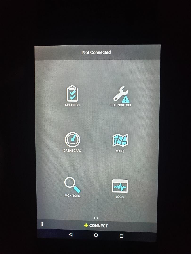

Got pictures taken, but there's a ton of glare. Going to try again tonight once it's dark. That will also let me use my computer to upload them instead of my phone.

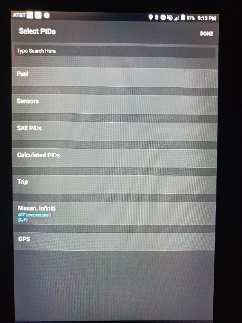

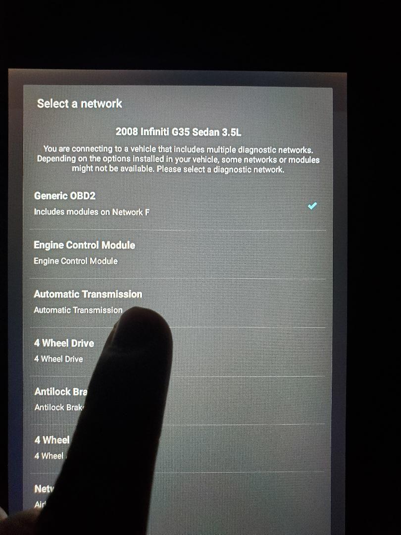

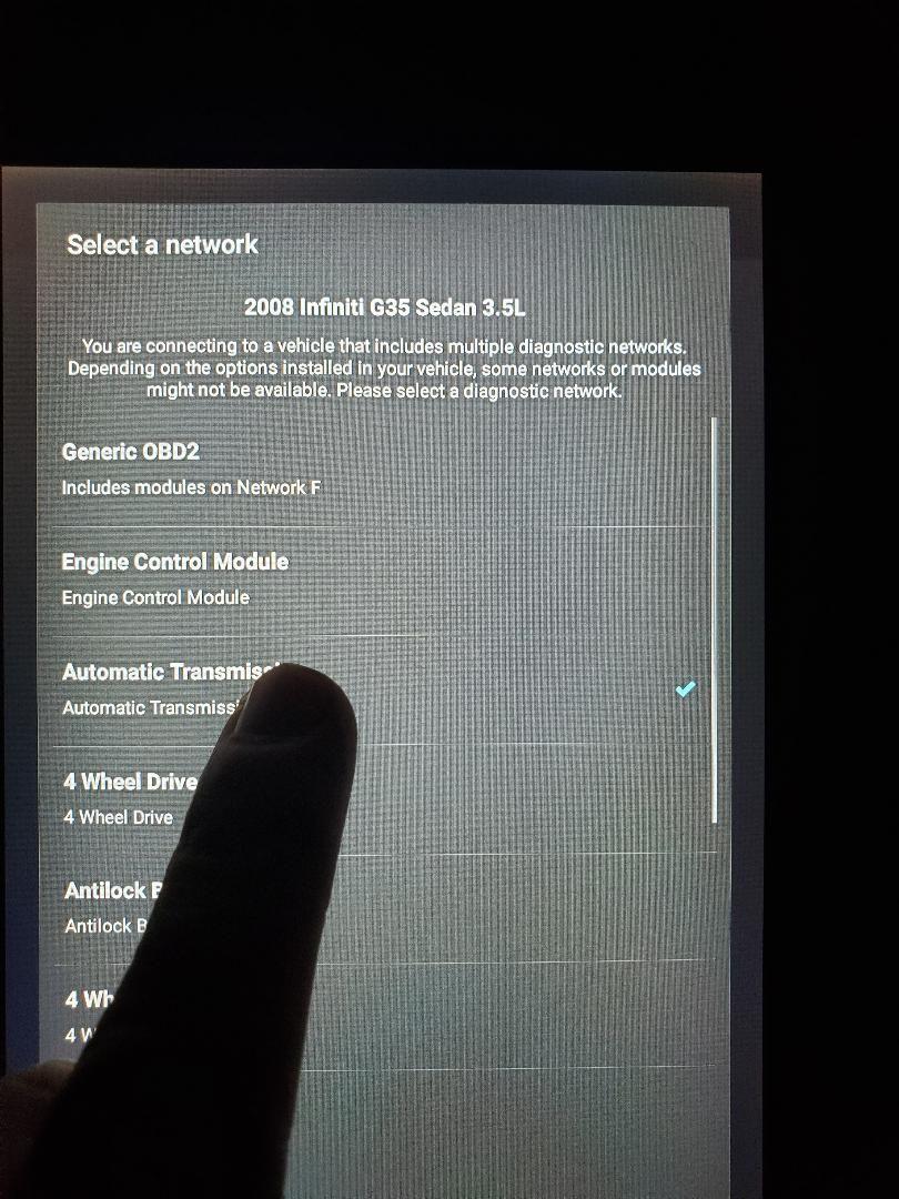

Ensure car is parked, engine off, ignition on, adapter plugged in and Bluetooth connected.
1. Select connect at the bottom of the home screen.
2. Look at the list of available networks.
3. Select Automatic Transmission, ensure the check mark is on the right.
4. Click yes on the Warning banner to proceed, do this while parked (a disclaimer, just like the warning banner).
5. Pick which gauge position you want to use for the temperature reading, touch and hold until it pops up the menu.
6. Tap on Display Configuration.
7. Select the Item drop down.
8. Select Nissan/Infiniti. It will give you only 1 option "Automatic Transmission", tap it.
9. Swipe down until you get to "ATF Temperature 1" and tap it. Click on "DONE" on the top right, and it will take you back to the gauge screen.
If it's still no go it's gotta be something with the technology package, as mine is a base model X, no tech package, no Nav, no Bose.

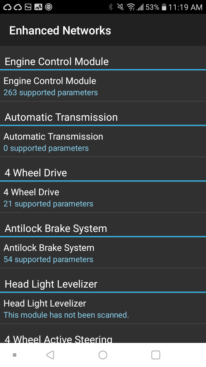

Thanks for posting pics. Yeah... been through all that. It does the enhanced scan of AT and I will see a scan of 1-100 but no PIDs are ever found so I can't attach one to a gauge.
I'll keep pecking away at it. Appreciate time others have done to test this out as well.

I tried from a fresh install and told Fusion to not scan for PIDs when connecting. I then was able to add the AT gauges as at this point app doesn't know what car is capable of providing.
I didn't expect much and still a no go. No PIDs found and gauges still have the AT variable defined but no communication or readings.

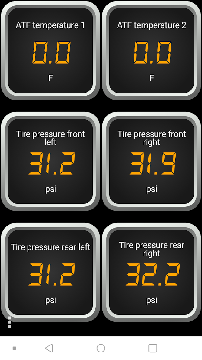

I hooked up one of my "real" ELM327 chipset readers I obtained from Romania a few years back and it was actually able to obtain TPMS data. Capabilities certainly depend on the OBD dongle. Several of my adapters will also display the TPMS ID in decimal. You can just run a conversion to HEX to get the your TPMS IDs.
https://elm-327.eu/
This is what I show for discovered PIDs

The tire pressure is really cool. I just tried it, I was able to find them and set up a gauge but got no reading. That being said I've had the tire pressure light on for about a year-and-a-half so all the batteries can be dead I guess
I went into diagnostics and found which sensor was bad, gave me a C1710 code which indicates data can't be received from the right rear transmitter. not sure if i'll bother fixing when I put on new tires or not.

I managed to find the tire pressure readouts in Fusion, still getting no reading on the right rear after a tire rotation, so I'm suspecting a bad receiver. Still haven't gotten my UltraGauge to read trans temps. And I haven't yet tried the info from the original post in my ScanGauge.

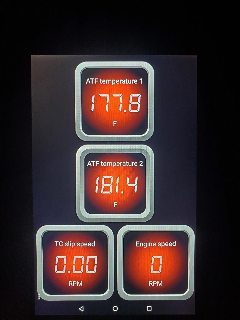

2 month update. Fusion works great, still haven't gotten my Scangauge or Ultragauge to read the trans temps, even after the firmware update on the SG. Only issue now is that my SG will no longer clear codes, not sure why, but I can still clear them with Fusion, so it's not really an issue.
