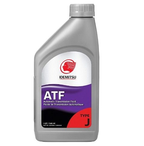

I know this may hijack the thread but anyone else using something other than matic s? I've been using Castrol multi-vehicle import for drain and fills around every 10k(2nd oil change) with no problems. So I'm almost at 100k using it.
I used Idemitsu Type J. FCPEuro was cheapest. Says it meets Matic J/D/K. Time will tell I guess.
Interesting that they call it "Type J". Many years ago, at the same time that Nissan introduced "Matic J", Castrol released their "J" ATF (only in Japan though) and there was apparently a fair amount of evidence that Nissan's fluid was in fact Castrol's "J" fluid. In the rest of the world, the equivalent fluid is sold by Castrol as their Import Multi-Vehicle ATF. After 100k miles, it would be hard for anyone to claim that this ATF is going to destroy your transmission....
